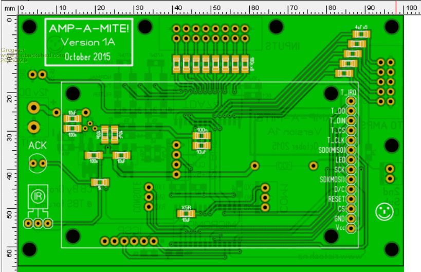

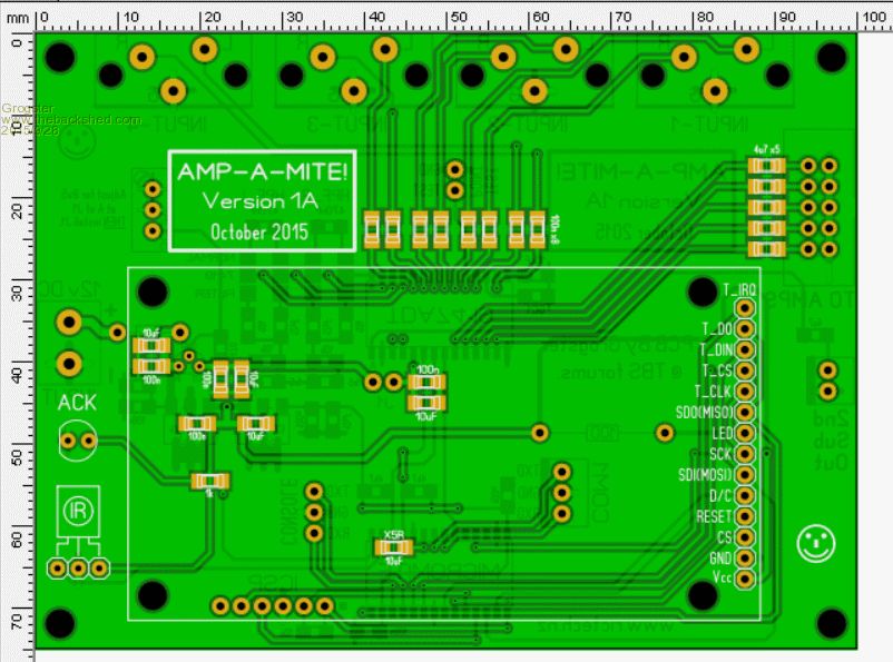

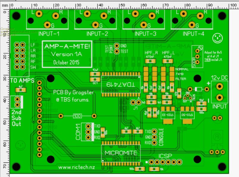

Initial PCB done. There are still some tweaks to do. It is 100x75.
TOP(LCD side):
BOTTOM:
I have never used the 7419 before, so I just copied the datasheet test circuit for the 1A board, so I can tinker. Inputs 1-4 are via dual-RCA sockets mounted on the board.
As everything to do with the audio side of things is done through I2C commands, I should be able to test out everything using test loops in the MM for a start, then once I get the hang of everything, I can write some proper code incorporating the LCD.

I am rehashing things a little now to make the board smaller, so it WILL fit in a 2U case, with plenty of spare room. I am moving the RCA input sockets to a seperate sub-board, which is still part of a 100x100 panel.
As to surrounds, no, I have not thought that far ahead - you are right.
PSU will most likely be any one of many of those switch-mode supplied you can buy for enclosed equipment. These can be had in quite juicy form(8 amps or more) and are quite affordable. The main amp module I am going to use for the prototype uses one of these @ 32v. There will be a pre-regulator arrangement(buck converter) to drop the 32v to 12 or 13 volts for the main preamp board here.
As the 7419 seems to want to settle on an 8.5v supply voltage, I elected to use a 78L05 5v regulator and 'Jack up' the output voltage by re-convincing the 78L05 as to where it's ground reference was. This is a very common move for changing fixed regulators above their set voltage.
The 7419 wants a supply between 8v and 10v - not much room to move. 8v is minimum, 10v is maximum. I could use a 7809 or similar I suppose, but all the data in the PDF seems to be done at 8.5v, and that is the nominal supply, so that is what I am designing it to run on.
LCD display LED backlight and IR receiver are on regulated 5v, and the MM and LCD controller are on regulated 3v3.
EDIT: I think I will just run the 7419 on 9v and be done with it. 9v is smack in the middle of the 8-10 volt supply range, and only 500mV higher then the 8.5v nominal figure anyway, and 8.5v nominal probably means closer to 9v anyway...Edited by Grogster 2015-09-30

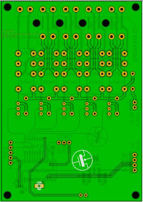

Posts: 10043
Posted: 09:01pm 28 Sep 2015
UPDATE
Board is 10mm smaller now - 100x65, so will definitely fit in a 2U case now, and the audio inputs are now on a IDC cable same as the audio outputs.
For line-level signals, IDC is fine, and in fact, if you look inside many a commercial amplifier, this is exactly how they couple their audio from board to board - via FPC cable or other flat multi-core.
...you can't do this with low-voltage inputs(Phono/Record-player cartridge or dynamic microphone), but this unit does not allow for that anyway...
The same 100x100 panel will now contain a 2nd board, which will be the input panel.
The input panel is linked to the main preamp board with 16-way IDC cable and plugs.
The signals are laid out as signal/ground/signal/ground, to minimize any crosstalk and to also allow nice easy connection by either IDC cables, or even just plain old jumper wires if need be.
The I2C bus and 5v supply are now also on a header, as I have plans for a 3rd board specific to my needs, which will be another MM controlled speaker A/B switching arrangement plus speaker de-thump relays.
TOP:
BOTTOM:
...the tinkering continues...

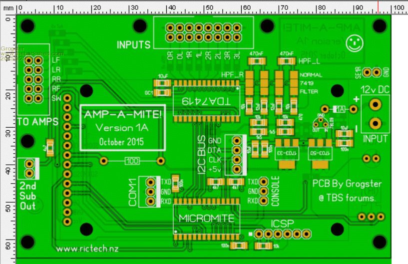

UPDATE

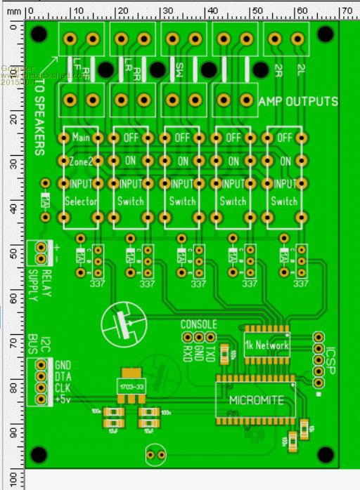

I have designed a speaker relay board, also controlled by a MM. This board serves a couple of functions: (1) speaker de-thump relays as all speakers are off by default, and (2) speaker switching and zone selector. All of these relays can be turned off and on via the main pre-amp's MM I2C Master and the GUI SWITCH controls, which allows for full control of which speaker sets you want on or off. At power-up, this board will enable all four speakers, the sub and select zone1 for the front speakers.
This board gets its power and I2C control from the main pre-amp board. The relays have their own supply line, as I have not decided on 5v or 12v relays yet - probably 12v ones as this will take the relay coil load off the 5v regulators. There are no pull-ups on the I2C bus on this board, as they are on the pre-amp board.
...i'm enjoying myself with this one, as audio and amplifiers are something I am into, so I can combine both my current interests at the moment...
