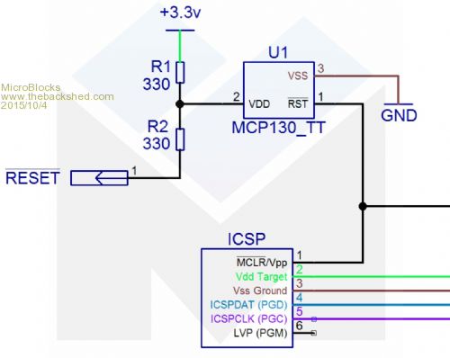

I made this variation of using a supervisory chip to provide a clean reset signal to the microcontroller.
This would eliminate any debounce when a switch is used for a manual reset. There would be no need for a R/C type debounce which could also interfere with programming a chip. I think this would be the cleanest way of having a reset signal.
I have protytyped it and it works good.
Any remarks on the schematic? Did i overlook something?
The chip has an operating current of around 45 microAmps and it trips with voltages lower then 3.0-3.15v
I would like to make this a standard part of any module that has an mcu.

Nice and simple, and looks OK to me.
This is an effective design, as pressing RESET will pull pin2 of the 130 IC to about 1.65v or so, thus tricking it into forcing a CLEAN reset state - clever.

My concern is the values of the resistors.
R1 will effectively make the treshold of the supervisory chip higher by 330x45uA = 14.85mv. So it will trip when the power supply is between 314.85 and 329.85.
That might be a bit to close to the 3.3v. A 100 ohm resistor for R1 will add only about 5 mv.
I also not want to much current to flow when the reset switch is pressed.
When using 100 ohm for both resistors the current is 3.3v/200 = 16.5mA. Way to much.
3.3v/660 will be only 5mA.
Maybe the best compromise is 100 ohm for R1 and 330 for R2.....
Practicing my Ohm's law calculations. :) With all the digital stuff it doesn't get the attention it deserves.

I just realized that i could just use a MCP130 that triggers on a lower voltage to compensate for the 330 ohm resistor.
I tested it with a MCP130-315 but without a variable power supply i did not test how it responds to little voltage dips.
I can replace it with 1 MCP130-300 which has a trip voltage of 2.85-3.00.

Won't this be a problem in Battery Operated applications ?
At 2.85 Volts your battery's still have life left and the PIC32MX can operate down to 2.3 Volts.
Just a heads up for low power battery applications.

The PIC32 can operate ok at those voltages, most other parts that are controlled by the mcu not so much.
When batteries are used it is best to either leave out the supervisory chip or up convert to 3.3v
