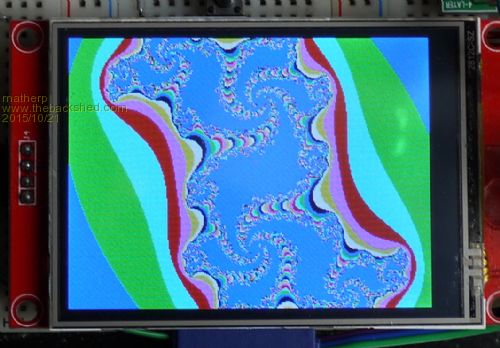

Posts: 11902
Posted: 01:00am 21 Oct 2015
This was drawn much much faster - 10 seconds
I've converted the JULIA code to a CSUB as an exercise.
This allows you to set the four parameters CRealVal, CImagVal, RealOffset, ImaginOffset in the call to the CSUB. Note that because of a limitation in CFunctions and CSUBs you have to call JULIA with variables rather than literals.
In the code I've included all the example parameters from loki's original post and the program steps through each one in turn taking about 10 seconds each on a ILI9341 driven by a MM+.
The code should work on any Micromite with any of the supported display types
I would like to increase the colour resolution by altering the way the RGB code is constructed in the DrawPixel statement but so far my attempts have failed - any suggestions appreciated.

The C code is attached so you can see how easy it was to do the port, just a question of converting the operators to function calls:

Posts: 11902
Posted: 01:54am 21 Oct 2015
  Quote  Are the FAdd, FMul etc part of the CX32 libraries ?
No, these are functions that Geoff has included in the MM firmware that can be called from CFunctions. They get round the fact that the XC32 compiler doesn't generate properly position independent code. All these helper functions are defined in cfunctions.h which Geoff distributes with the Micromite firmware.
Here is CSUB Mandelbrot: 20 seconds on a MM+/ILI9341

Posted: 02:34am 21 Oct 2015
Thanks peter!
I like it!
This are the times (in ms) for Julia on a MM2@48Mhz:
23006
33838
37001
30370
11832
11428
10773
31263
12742
10660
32165
16738
35920
For my old MMbasic 4.7b32 i had to convert the CSub to a CFunction.
ed: but it is actually sufficient to rename CSUB to CFunction.
edit:
Mandelbrot takes 31432ms on a MM2@48Mhz (BP170 w. 240x320LCD)
MichaelEdited by twofingers 2015-10-22

Posts: 6607
Posted: 10:50am 21 Oct 2015
A few more speed observations for the plain 'basic' version.
With my MM+ and 7inch display, the Julia set took 1979 seconds.
Change
CY = Y * YDelta + ImaginOffset
Zr = CX
Zi = CY
to
Zi = Y * YDelta + ImaginOffset
Zr = CX
and
new_Zr = Zr * Zr - Zi * Zi + CRealVal
new_Zi = 2 * Zr * Zi + CImagVal
Zr = new_Zr
Zi = new_Zi
to
Zr = new_Zr
By eliminating two lines of unnecessary assignments, the time reduced to 1791 seconds.
It makes the code less readable but with a significant speed improvement.
I am 20 minutes into another test run which is looking promising.
Posts: 6607
Posted: 06:02pm 21 Oct 2015
Last play. Changed the DO... LOOP to FOR... NEXT
FOR X = 0 TO (MM.HRES-1)
CX = X * Xdelta + RealOffset
FOR Y = 0 TO (MM.VRES-1)
Zr = CX
'Begin Iteration loop
FOR COUNT = 0 TO MAXIT
IF ( Zr * Zr + Zi * Zi ) >= 4 THEN EXIT FOR
Zr = new_Zr
NEXT COUNT
PIXEL X, Y, (COUNT AND 4) * 4177920 + (COUNT AND 2) * 32640 + (COUNT AND 1) * 255)
NEXT Y
NEXT X
Time down to 1616 seconds

Posted: 08:12pm 21 Oct 2015
Nice, Jim.
On my MM+ with 320x240 ILI9341 screen, your last version takes 286 seconds.
By knocking the variable names off the NEXT statements, it drops to 277.5 seconds.
