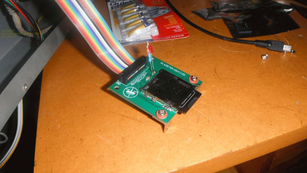

I'm using a 1206 SMD LED. I have removed the LED and the 1k pullup for now, but I will perform the following test:
1) Replace the LED and 1k with new ones
2) Reconnect to the MM+
3) Connect the CS line to a standard I/O pin
4) Set that pin low to hold the CS line low.
At this point, the LED should be lit, and I will measure the voltage on the CS pin on the SD-card socket with respect to ground.
EDIT: Here is a shot of my SD-card carrier. I note I have forgotten the 100k to deck you have on your design.... Would this be the cause?

Posts: 10044
Posted: 01:33am 15 Jan 2016
UPDATE
YES - SD card WORKS with the LED shorted out, and 1K still in place.

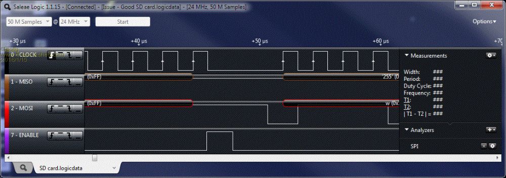

you don't perchance have a digital scope there do you? it would be interesting to capture the -SEL (CS) pulse happening, along with the SPI clock line to see how much leeway there is between the -SEL signal being asserted and data communications with the card starting. similarly, the time between communications finishing and -SEL being released.
my suspicion is that (a) -SEL is controlled entirely at the discretion of the MM firmware, and (b) that the timing is a tad tight at one end or the other. note that different SD cards will have different requirements regarding the margins required - so whereas some cards may be ok, others will fail to function. i have seen such problems in a real-world product that a company i worked for shipped out to customers. our solution at the time: customers were told they should only use cards 'certified' (and sold) by us!
if it is just a timing issue, it can almost certainly be fixed by geoff with a few strategically placed NOP instructions.
