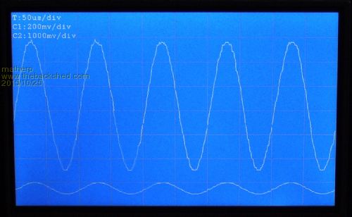

This is starter code for a 2 channel oscilloscope using a MM+ and a 800x480 SSD1963 display configured using the normal OPTION LCDPANEL command.
Starter code means that there is no GUI and of course to be properly useful the MM+ needs a programmable attenuator/gain stage building out of standard analogue hardware as a front end to the ADC.
However, the guts of the oscilloscope are fully worked in so far as it supports:
* 800x480 display divided into 10x8 divisions (the graticule lines are just visible in the picture)
* 2 channels at speeds up to 1.8 million samples per second per channel with 10-bit resolution
* continuous screen updates at a rate of 20 traces per second
* individual on/off channel switching
* programmable timebase specified in usec/division
* automatic display scaling if ADC cannot satisfy specified usec/division
* separately programmable amplitude for each channel in milli-volts per division
* free-running, or triggering off either one or both input channels with separately programmable positive or negative slope
* Trigger timeout that returns control to basic if no trigger occurs with 0.5 second
All of the above is controlled by one CFunction "scope":

Using this the current test main program is absolutely trivial:

If someone would like to build a GUI for this to allow all the various parameters to the scope function to be controlled using the touch screen, let me know
The Cfunction follows my usual route of being Basic coded into C. The only tricky bit is the code which sets up the ADC to run flat out continuously which was cribbed pretty much completely from the plib documentation.
The CFunction source and the complete Basic test program are attached.
2015-10-25_174312_scope.zip
If you have the hardware give it a run - I think you will be further impressed with what the MM+ is capable of.

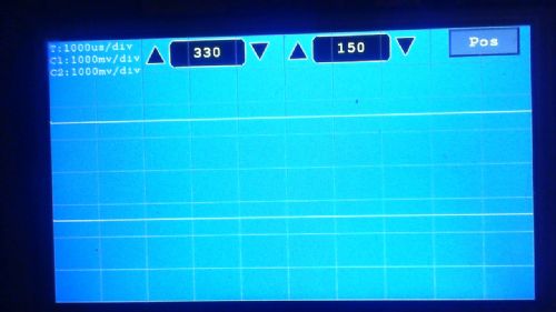

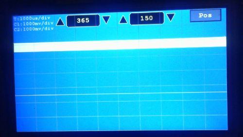

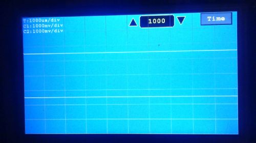

Posted: 04:31pm 28 Oct 2015
First Try - Scope GUI..
I know it's not much yet, but wanted to get some feedback...
The attached code is from the first Matherp post on the SSD1963 code.
I tried to keep the scope CFunction running all the time.
The two simple screens just adjust time and ch1, ch2 screen positions.
but, I ran into trouble trying to adjust the trace position in real time.
I seems that the Cfunction doesn't cleanup behind the position change...
Probably something I'm not doing right yet...
2015-10-29_023049_scope_gui_SSD1963.zip
Anyway, will keep at it, time permitting... (go bed now)...
Yikes... And now a logic analyzer display too... Awesome Peter..!
