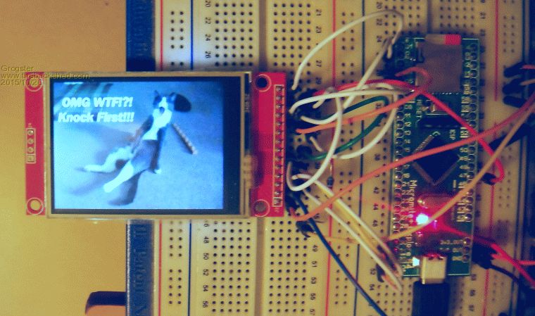

Is anyone successfully using a SD(HC) card formatted as FAT32 with a 64pin MM+ (B37)?
I am still trying to resolve my LOAD IMAGE issue (that doesn't work on my SD card). I can still read & write program files to my 'old' SD card from a MM+ confirming all is ok with the SD socket.
However, any SDHC card I insert (formatted as FAT32) is not recognised by the MM+ in any way. The Advanced user manual says FAT16 or FAT32 is useable, and up to 64Gb (I am using 8Gb).
Also, does anyone know a way to format an SD card as FAT16 from W10? Only options available by default are FAT32, NTFS and exFAT.

I have an 8GB SDHC class U1 formatted in FAT32, and I can load images fine....
Posts: 2991
Posted: 01:18am 26 Oct 2015
Thanks G for letting me know yours works fine.
What on earth is going on here? E64, external SD socket, ILI9341 TFT & touch. SD card reads & writes files but appears too slow to keep up with LOAD IMAGE. 8G SDHC card (FAT32) just not recognised at all. Tried multiple SDHC cards now and nothing.
Will try the SD org guys and format in FAT16 to see if any different.
If all else fails then I am going to build a brand new 100pin MM+ set-up and try connecting everything all over again!

Posts: 2991
Posted: 01:31am 26 Oct 2015
  Grogster said  . . . not my cat. . .
Don't believe you
SD formatter doesn't allow you to choose FAT16
100pinner here we come . . . . .
