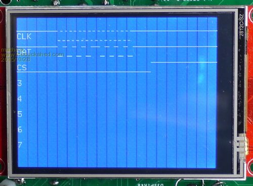

Using the same basic approach as for the oscilloscope, I've written the guts of a 8-channel (6 channel on 28 and 44-pin parts) 7.5 million samples per second (3 million of 28 and 44-pin parts) logic analyser.
The picture shows a capture of an SPI command "SPI write 2,&H55,&HAA" and is triggered on the negative going edge of CS. The example code allows labels for the channels to be assigned in a string array for display.
As with the oscilloscope, the same code runs on all Micromite variants and supports both SSD1963 (800x480) and ILI9341 displays.
Also as with the oscilloscope, I've created the guts of the application but it needs a GUI.
There are two CSUBs that do the work:
Subroutine "Capturelogic" captures 8 channels of data
Parameters are:
1: Number of CPU ticks per sample; use function "tickspersample" to calculate this from the desired # of samples per second. This is calculated based on CPU speed but the higher the speed the faster you can sample
It is rounded to be exactly divisible into the CPU speed and the actual speed reported
It cannot be below 8 in order for the capture code to complete in time
2: Number of samples to take; this is also used to scale the integer array "buff", 8 samples are packed into each array element
3: Buffer to receive the data
4: Pin number used to trigger capture
Set to zero to start immediately
Set positive number to trigger on positive going edge on selected pin
Set negative to trigger on negative going edge on selected pin
The second CSUB is Drawlogic:
Subroutine "Drawlogic" draws on the screen up to 8 traces
Parameters are:
1: Start position in record (0-samples%)
2: Scaling to use
Positive numbers cause the display to skip every "scale" records, i.e zoom out
Negative numbers cause the display to repeat every "scale" record, i.e zoom in
3: Start position when last drawn: Use the same as "start position" for first time called
Used to remove the previous display when scrolling or zooming in or out
4: scaling when last drawn: Use the same as "scaling" for first time called
5: Channel mask : set bits to enable display of a particular channel
6: Number of samples in record; this is used to ensure the display does not try and read outside of the valid data
7: Buffer containing the data

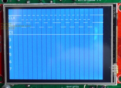

The second picture shows the same capture zoomed x2 and the start point scrolled
Drawlogic is the key routine. This allows one data view to be replaced by another using the same dataset very quickly by first erasing the previous data and then replacing it with new. A GUI could allow zoom-in, zoom-out, jump to location, scroll left and right all of which are supported
