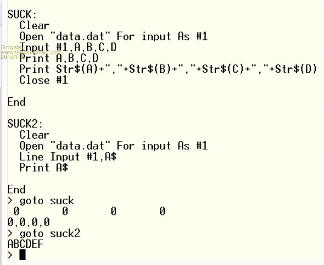

Is your datafile comma seperated or just raw data bytes one after another?
EDIT:
Example of comma separated: 001,125,231,045,002
Example of raw bytes: ABCDEFEdited by Grogster 2015-11-06
Posts: 10044
Posted: 04:33pm 04 Nov 2015
In my experiements, I am unable to get anything other then zero's out of the input command - perhaps a bug?
I can get the bytes using LINE INPUT, but NOT via just the INPUT command.
Comments?
DATA.DAT is a single line - "ABCDEF<cr>"

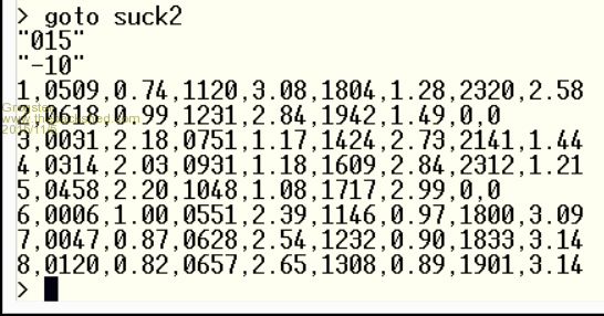

Posts: 10044
Posted: 05:23pm 04 Nov 2015
I am getting results using LINE INPUT, but still not the wanted using INPUT.
This example just reads the firt ten lines of the file.
It does nothing with the data, except prove that it is reading it fine.
We could write some code toe extract the data in the strings to the values you need, or if all you wanted to do was show it on the screen, then job done.
Naturally, there would still be a little bit of manipulation needed yet to find the correct dataset, and then find the correct starting point, but that isn't that difficult.

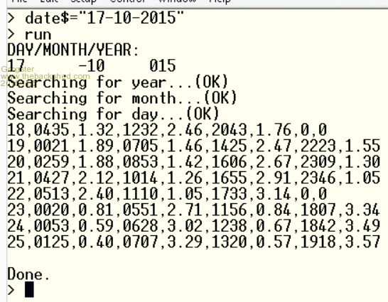

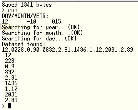

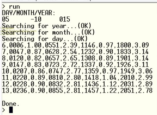

Posts: 10044
Posted: 08:30pm 04 Nov 2015
Try this:
START:
year$ = Right$(Date$,3)
month$ = Mid$(Date$,3,3)
days$ = Left$(Date$,2)
day = Val(days$)
Open "paul.dat" For input As #1
Print "DAY/MONTH/YEAR:"
Print days$,month$,year$
Print "Searching for year...";
Do 'look through the data for the year eg: "015"
Line Input #1,year2$
If Mid$(year2$,2,3) = year$ Then
Print "(OK)"
Exit Do
EndIf
Print "Searching for month...";
Line Input #1,month2$ 'look through the data for the month eg: -10
If Mid$(month2$,2,3) = month$ Then
Print "(OK)"
Exit Do
EndIf
Print "Searching for day...";
Do ' look through the data for the correct day
Line Input #1,day2$
If Mid$(day2$,2,1)="," Then
daze$="0"+day2$
Else
daze$=day2$
EndIf
If Mid$(daze$,1,2)=days$ Then
Print "(OK)"
Exit Do
EndIf
'At this point, we should be at the right place in the datafile
For X=1 To 8
Line Input #1,L$
Print L$
Next
Print:Print "Done."
End
I have tried setting the date to both a single-digit, and a double-digit.
Results:
DATE$="05-10-2015"
DATE$="17-10-2015"
These test codes make no allowance for the date being close to the end of the month, and there not being eight days to read from the file - that would require a little more code.
