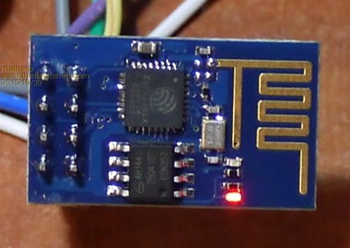

Thanks to viscomjim I've just wasted (spent profitably?) a day playing with the cheapest version of the ESP8266 modules - the ESP-01. There are lots of other variants but they all use the same underlying chip - ESP8266EX
First a warning: to run Basic it needs a 1Meg x 8-bit or bigger flash chip. This version only has a 512kb x 8-bit chip - easily replaced though.
However, it can run lots of other things.
To program it you need to download some suitable programmer software. Programming takes place over a normal USB/UART.
Google will uncover lots of information on programming but for the ESP-01. I connected as follows (viewed as in photo):
_________________________________________________________________________
| RX-pin on UART: GND |
| 10K to 3V3 : NC |
| 10K to 3v3 and switch to GND : 10K to GND |
| 3V3 : TX-pin on UART |
To program I found it best to hold the chip in reset with the switch to GND and then release it just before starting programming and it works perfectly everytime. Programming can be controlled using the DTR and RST pins on the USB UART but this relies on full function USB drivers and correctly implemented USB hardware so it is easier to do it manually.
The ESP8266 has a bootloader that can load programs and store them in the SPI flash memory which is included on all of the modules.
The programs can be all sorts of things and not just the buggy modem like "AT" interface:
Python
Basic
A Lua interpreter
Or you can link additional modules into the Arduino IDE and program it exactly as you would an Arduino.
As I'm waiting for a bigger SPI flash to try Basic, I loaded the Arduino modules and had a play with that - it works superbly. Attached below is one of the example programs that connects via wifi to your router and then interrogates an NTP server. The output in the example is sent to the ESP8266's serial port and is verbose but could easily be cut back to act as a time source for a Micromite not bad for a $2.59 module!
One of the things I really like about the ESP8266 environment in general is the use of the SPI Nand Flash. This is organised as a simple file system using the spiffs software. Geoff: if you are reading this, spiffs would be a great addition to the Micromite
The esp8266 is really a very powerful microprocessor in its own right that also happens to support wifi networking. The Arduino reference for the ESP8266 is worth looking at just to see the scope of the chips capability.
All in all, the ESP8266 looks like a very good candidate for many embedded applications either as a support chip or just by itself and it is certainly the easiest way into the Internet of things (IOT) that I have found.

jman
Joined: 12/06/2011
Posts: 711
Posted: 08:00am 30 Oct 2015
Hi
Did you see this post NTP Clock
The linked post is an NTP clock in basic
Jman

Posts: 6607
Posted: 10:46am 30 Oct 2015
I have a couple to play with when time permits.
I have also ordered one with more memory and more IO pins exposed.
What I really want it the equivalent in Ethernet instead of WiFi.

Posts: 11902
Posted: 11:25pm 30 Oct 2015
  Quote  Please can you share which part number you ordered
I ordered:
RS 7824651 5 Flash Memory 32Mb SPI,3V,108MHz,SO8
but wait til I've installed and I'll confirm it works

Matherp, if you haven't taken apart your board yet, this was just posted on the forum...
"Posted a new build after upgrading my arduino esp8266 arduino environment.
512k works now and is in the list.
Get the latest version from http://www.esp8266basic.com/download.html"
Posts: 6607
Posted: 10:15pm 31 Oct 2015
It took me a lot of failed attempts but I finally managed to program one of my 512k modules.
It is very interesting and shows a lot of promise.

Posts: 11902
Posted: 03:32am 01 Nov 2015
  Quote  but any 'advice' about potential 'traps' would be good
If you follow the wiring in my original note it should work first time as follows:
select the options in the flash program (size and com port)
Then hold the ESP in reset and press "flash", immediately release the reset and all should work fine.
I found the key was to keep the ESP in reset until after the flash program is trying to write.

Posts: 6607
Posted: 10:09am 01 Nov 2015
I didn't try holding the chip in reset until just before programming as Peter suggested.
I followed the 'brief' instructions at http://www.esp8266basic.com/flashing-instructions.html
I tried different USB-TTL adapters (ended up with an FTDI one).

UPDATE
The mod to increase memory on the ESP-01 didn't work. Despite specifically searching on RS for a SOIC part, the part I received was SOICW so didn't fit the pads. I tried to bodge it but it didn't work. Too many variables to know why. I replaced the 512K part and all works fine again.
The Basic for the ESP8266 continues to improve, I2C now working, but is PRIMITIVE in the extreme compared to MMBasic. However, the web access is very easy so probably worth persevering given the parts are so cheap.
This is very early days for the Basic development but the developer is extremely responsive both to additional functionality and bug fixes.
I bought a ESP-07 module to get more memory except it turned up with only 1M rather than the advertise 4M . It is however easier to breadboard than the ESP-01 and has more pins brought out. ESP-12 is probably the best way to go for a development environment.
Programming the new releases of the firmware continues to give no problems as long as GPIO0 is tied low and the device is held in reset until after the flash button is pushed.
