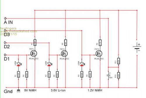

this diagram shows a new "ready to use" battery ("200mAh", brand name).
This project needs only a few cheap parts and can easy be made
on a perfboard (perfboard design by using "BlackBoard").
In addition to your MicroMite2 of course (four pins)
and some cheap connectors/adaptors.

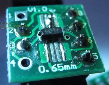

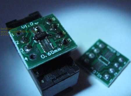

Instead of the TO220 IRL540 logic level N-MosFet
I used this time the tiny IRLML2502 on a adaptor PCB.
(eBay 20PCBs/1$, SMD to DIP8, 0.65 1.27mm)
designed by using "BlackBoard circuit designer".

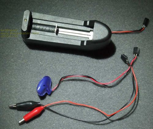

I modified a cheap LiIon-loader (1$ on eBay) and can use it
for AAA, AA and 18650 cells.
no cut off (don't do that!).
some of them are strange ...

' This is the schematic example for a simple 9V discharger:
' A IN
' o-----------+ o---------------o----------+
' | .-. Disch.R .-. |
' | | | 470R R3 | | |
' <- MM2 | | | R2 820k| | |
' | | | | Battery
' D OUT | | | ---
' o--------o------+ D| | | -
' | | ||-| N-MOSFET | | |
' | | ||<) IRLML2502 | --- |
' .-. +--||-| T1 .-. --- |
' R1 | | G S| R4 | | | C1 |
' 100k | | | 100k | | | 100n|
' o--------o------------o---------------o----o-----+
' GnD
' Recomended values (R2):
' 1.2V NiMH 1500-2500mA: C/10 = 200mA = 4,7R/Threshold: 1V
' 3.6V LiIon 2000-3000mA: C/10 = 200mA = 18R /Threshold: 3V
' 9V NiMH 150-250mA: C/10 = 20mA = 470R/Threshold: 7V
' (3x) R1=100K, 1/8W
' (3x) R2a=470R, 1/4W (b=18R, 1W, c=4.7R, 1/2W)
' R3=820k, 1/8W
' R4=100k, 1/8W
' C1=~100n
' (3x) T1=N-MosFet, logic level (IRL540, IRLML2502, ...)
' voltage drop on T1 = 1.3mV
' see ->>MMDIS.JPG for the real thing
