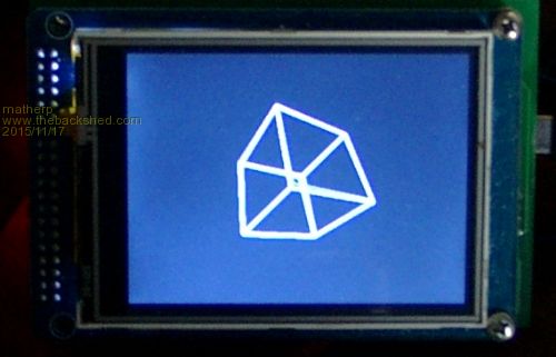

Please excuse the picture, my good camera isn't available.
This is a demo program (all in Basic) of some interesting maths that underpins all sorts of technologies like attitude/heading systems and 3D graphics.
Quaternions are a mathematical technique that allows the rotation in any direction of any shape. The maths behind it are way beyond me and extend the concept of complex numbers such that:
i*i == j*j == k*k == i*j*k == -1
I find that equation completely bemusing
However, quaternions are pretty easy to use in the real world. There are some gotchas: quaternions are not commutative e.g q1 * q2 does not give the same result as q2 * q1. But overall the calculations are pretty simple.
The attached code draws a wireframe cube and then rotates it continuously in the directions specified by the rotation quaternion.
The cube is specified as a set of coordinates around a point 0,0,0 in the array "cube". Then the array cubelines% is used to store the coordinate pairs that make up the lines that draw the cube.
The array "cubelocation" defines the actual position of the cube in space. The x and y axes are as per the display and the z axis comes out of the display towards the viewer.
The code uses a projection method of perspective to visualise the cube in 2 dimensions and "viewplane" defines the location of the projection plane in the z axis.
All quaternion arithmetic is carried out with the quaternion normalised. The subroutine "create_normalised_quaternion" takes a rotation vector and an angle and converts it into a quaternion.
Then to rotate a point we just multiply the rotation quaternion by the normalised coordinates of the point and then multiply the answer by the inverse of the quaternion. Note how in normal math this would leave the point unchanged but because of the non-commutative nature of the quaternion somehow the sequence does what we want (look at Jorge Rodriguez excellent videos on Youtube if you want to know more). Note that no trigonometry is needed other than in the initialisation of the rotation quaternion and that only uses the sine and cosine of a single angle.
The attached code includes all the routines necessary to rotate objects in 3D and then project them onto a 2D screen.
My interest is in using the math to understand what is happening inside a Attitude and heading reference system (AHRS), but the example code below is quite fun.
The code should run on any type of Micromite with a connected TFT display. The picture is of a 320x240 SSD1289 display driven by a 44-pin uM2.
Play with this line:
create_normalised_quaternion(2,1,0,0,q1())
to change the way the cube rotates. The parameters are:
number of degrees to rotate about the rotation vector
x-coordinate of the end of the rotation vector
y-coordinate of the end of the rotation vector
z-coordinate of the end of the rotation vector
array to receive the quaternion
Enjoy

twofingers
Joined: 02/06/2014
Posts: 1773
Posted: 06:59am 17 Nov 2015
Hi Peter,
you scare me. Do you never sleep?
It looks very nice on my MX170.
I would never expect that this could be done in pure basic.
It gives me a ELITE feeling.
Thanks!

Posts: 2991
Posted: 07:04am 17 Nov 2015
Got half way through your post and now my head is spininng too as well as the cube!!
Is it recommended on an SPI display (ILI9341) or are these way too slow? I am not near a MM at the moment but have always wanted to 'animate' a cube in the corner of a TFT (spinning logo effect).
WW
Posts: 11902
Posted: 07:06am 17 Nov 2015
  Quote  Is it recommended on an SPI display (ILI9341)
Should be fine

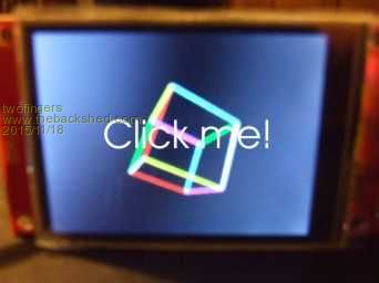

twofingers
Joined: 02/06/2014
Posts: 1773
Posted: 06:00am 18 Nov 2015
I use a BP170 and a chinese 2.4" ILI9341 display without any problems.
I can't imagine that Peters code can overstress this displays.
Maybe a different pin layout could help to catch the issue.
My pin layout (BP170):
OPTION LCDPANEL ILI9341, L, 4, 5, 6
OPTION TOUCH 7, 2
I used Peters code to make a MM Screensaver (assuming it's okay for Peter to post it here). This is a DEMO to show the versatility.
Michael
EDIT:
BTW. the framerate is ~8 FPS on a MX170/28 @48MHz.

I clicked on the image above ( the "click me" graphic ) ..I expected a
small video like a youtube clip. But it sent a zip file instead,
I would guess with the quaternion basic source ( don't know as
I deleted it ). Was that the intent ?
(I'm not after quaternion code, just thought it would be a nifty video)
