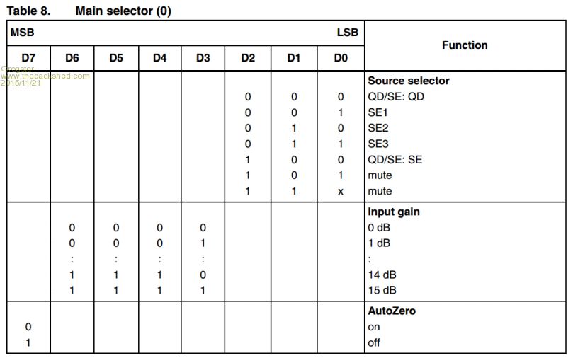

Hi folks.
In the stereo project that jman is helping me with, he wrote most of the code to manipulate the bits of the data byte for any address that you send off to the pre-amp chip, but I would like to understand how this actually works.
Take the following snippet from the manual:
As you can see, this byte consists of several things you can adjust, those being the input source selector, the input gain, and the AutoZero feature.
I understand how all this changes to get you what you want, but what I DON'T understand, is the mathematics behind how you manipulate the bits of the byte to get the final byte you send off to the device with the settings you want.
Take for example, the case of wanting SE1 input, 3dB input gain and AutoZero off.
This would result in a final byte of &B10011100, or 9Ch(156 decimal).
That's fine, and I follow all that just fine, but the problem I am having is in working out HOW you combine the values into the one byte.

  Grogster said  Take for example, the case of wanting SE1 input, 3dB input gain and AutoZero off.
According to the table, shouldn't that be &B10011001
I haven't got to the end of your post yet, but hope this isn't the issue

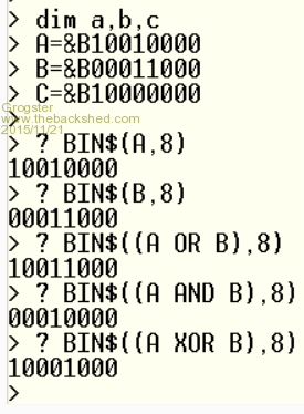

Thanks - will experiment with your demo code.
These are the results I got:
I will play around more with your demo code.
Still lost, but I will persevere.
It would seem that what I need is the ? BIN$((A OR B),8) command?
So therefore, A OR B should give me the combined result, yes?

  WhiteWizzard said  According to the table, shouldn't that be &B10011001
Yes, it should - typo - sorry.

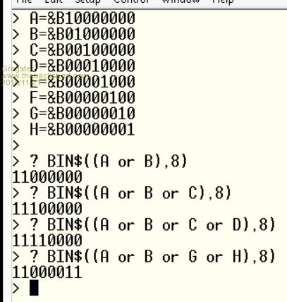

Ahhhh - I think I am making slow progress.
Some experiments:
If I OR anything together, this would seem to put the bits where I need them.
I don't know if this is just because of the way I have setup my example or not though.

OK - there are many ways to get the end result - however, you have specifically asked about a 'simple' way of 'adding' the numbers.
My approach would be (based on the example chart) to have three variables representing AutoZero (0-1), Input Gain (0-15), and Source (0-7).
So each of these three variables take on only one of their possible values. The approach is then set/change any variable, then call one common sub to 'compile' the resultant byte.
So to compile the resultant byte (call it x, and initially set x=0) the AutoZero value (0 or 1) needs to be multiplied by 128 (or shifted 7 bits left), and then OR'd with x (or added to x), the Input Gain multiplied by 8 (or shifted 3 bits left) and OR'd with x, and the Source left as it is and OR'd with x.
If you now wanted to go from 3dB to 2dB you need to change ALL the relevant bits in the byte i.e. for gain, bits D3, D4, D5, and D6; while leaving all other bits (i.e. other functions) untouched. This is where I think you are after a 'simple' way to do it.
Again, many ways to do this including masking, XORING, shifting. But I would simply call the same routine I outlined above which will then adopt any change in value in any of the three functions.
The above approach is useful when you have a variable/feature that takes on a 'direct' binary value such as the input gain. So here, the binary range is 0000-1111 which represents a 'human' range of 0-15.
The approach above allows you to keep a variable called InGain to a human readable number of 0-15 which makes the code nice and easy to read.
However, all that said, if you several 'features' in a byte that have no 'human' meaning (typically one or two bits in the byte), I would store these as binary values. So in the above example, AutoZero would be &B10000000.
Then this becomes like your 'A,B,C example you gave where all you need to do is OR the bytes together to initially compile the result (or add them together as you put it!). Now to change a 'section' of the byte without altering other functions/bits the approach I would use is a two step process: First to mask out (with AND), then OR the channge to get the result.
So going from 3dB to 2dB:
&B1 0011 001 Initial byte value (AutoZero, 3dB, SE1)
&B1 0000 111 (mask out the function changing by ANDing with this)
=B1 0000 001
B0 0010 000 (OR with the new Gain required)
&B1 0010 001 (AutoZero, 2dB, SE1)
Now define simple!!! I personally prefer the three variables, one sub method!

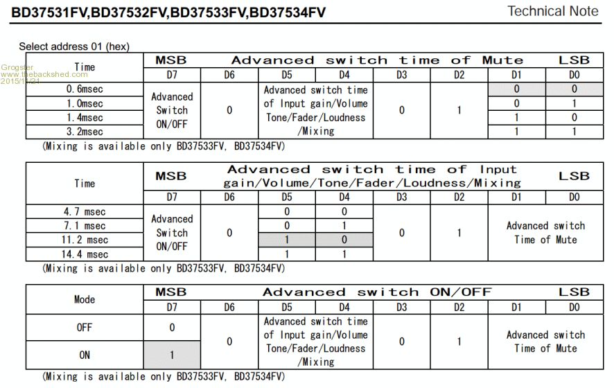

I have some simple code working now, and I think this is the way I will proceed forward - some of you will not agree with this method, but I can understand it when done this way.
Here is a section of the ROHM processor manual:

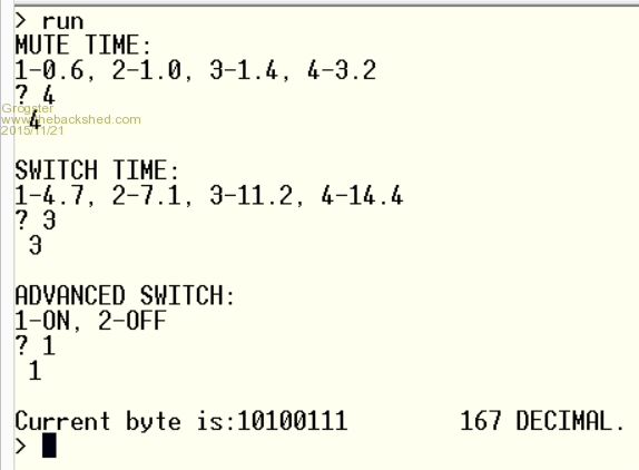

My experimental code:

Print "Current byte is:";
BITE=(MT Or ST Or ASS)+4
Print Bin$(BITE,8), Str$(BITE)+" DECIMAL."
End
Done this way, with lots of constants, I can just easily or them together as discussed, and this seems to be working fine for building the data byte. The line that builds BITE, has "+4" on the end, as the data byte always has bit2 set for this command, and that also seems to be giving the correct results.
As I am keeping all the values in constants, there is no need for a sub to compile the byte as it can be done easily in one line.
I am looking into storing all this data in an array rather then pages of constant commands.
