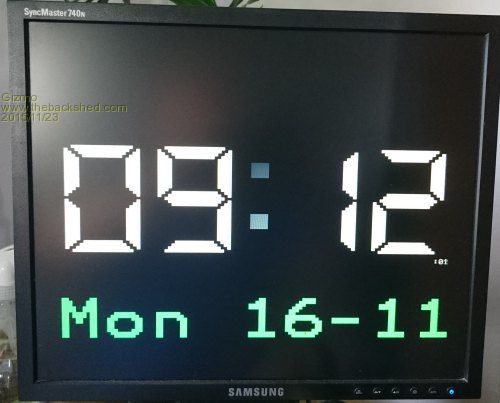

This is a project I put together for a customer. They needed a workshop siren, something that could be programmed, to sound a siren for a few seconds at preset times.

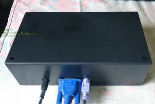

I based it on a Colour Maximite from Circuit Gizmos ( thanks CG ), because it had the build in real time clock and the "sea of holes" for the extra circuitry. The board was fitted into a plastic case from Jaycar, with the VGA, PS2 and Power connectors on one side, and access to the SD card on the other.
The actual siren device the customer wanted to use was a unknown, so to make it easier, I used a Arlec wireless power outlet, from Bunnings, about $13. See this thread that goes into it in more detail. This way the customer could just plug a 240v powered siren, light, etc, into the power outlet, and not need a electrician to wire it up for them. Plus it means I dont need to touch any 240v wiring myself, with is illegal unless you have a license. While this sort of 240 circuitry is easy to do, the implications of a mistake could lead to jail time, its just not worth the risk.
The Arlec remote power board came with a wireless remote control unit. The remote control runs off 3v, and has proper push button switches, which means I could use the Maximites 3v supply to power it, and simple opto couplers to act as the swtches. The remote draws about 9ma when transmitting, well within the Maximites 3v supply capabilities. The opto-couplers inputs are driven by 220r resistors from Maximite outputs 1 and 2, and the opto's output directly across the switch terminals on the remote control circuit board. Needed to check the polarity across each switch, as the outocouplers I used were transistor output so would only pass current in one direction.
The remote control circuit board fits over the Maximite, held up with a few short lengths of copper wire. The opto-couplers are hidden underneath.
The remote has a ON switch, and a OFF switch. So to sound the siren for a few seconds, the code operates the ON switch ( optocoupler ) for half a second, waits a couple of seconds, then operates the other switch to turn off the siren.

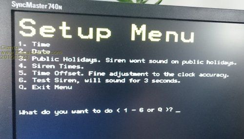

The software is not well written, bit old school, but it works. The main screen displays the time and date. Hitting any key brings up a menu, where you can set the current time and date, time offset, siren times, holidays and a test function. If any of the screens are left open for too long, the watchdog resets the chip and the program restarts.
Setting the current time and date is obvious. You can also set up a few dates that you dont want the siren to sound. Used for public holidays.

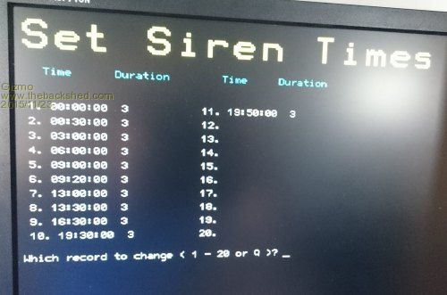

There are 20 siren time slots per day, and you can have different times for different days. The siren duration can be set from 1 to 5 seconds.

Out of interest, is that an ABS enclosure or a metal enclosure? The reason for asking is to highlight that a metal enclosure will have an impact on RF range. Guess you probably know that anyway, but just in case. . . . .
