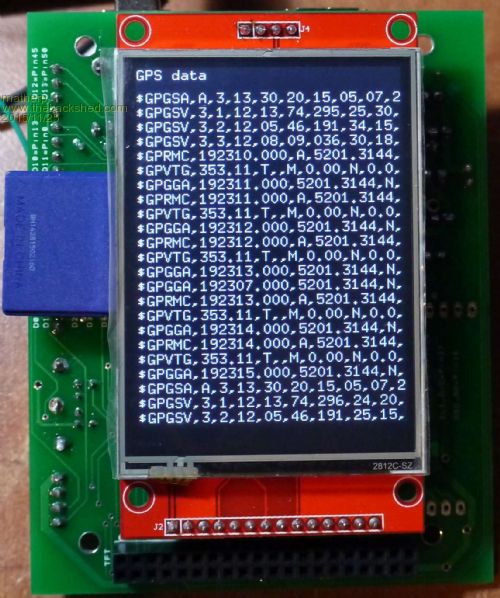

Has anyone (@matherp, maybe?) done full or partial scroll with a ILI9341 display?
http://rittle.org
Posts: 11902
Posted: 02:45am 25 Nov 2015
  Quote  Has anyone (@matherp, maybe?) done full or partial scroll with a ILI9341 display?
Can only be done by keeping a map of what is on the display in MM memory. You can't read from the display memory on the ILI9341 when using SPI for reasons I don't understand - could be just bad implementation of MISO on the ILI9341 boards.
It does have hardware scroll of the complete screen width (page 120 ) but this is limited in what it can do but should be programmable from BasicEdited by matherp 2015-11-26

Have a look at this
and this:
If the display is in landscape mode the text scrolls sideways and you can go 1 pixel at a time. This is all the hardware can do.
Code below, tested on MM+ but should also work on uM2:

Also:
' Demo of scrolling text in a display - GPS monitor
option explicit

text 0,0,"GPS data"

Possibly, but the fault report doesn't mean anything. Paceman has confirmed it works on uM2 and I have it working on MM+, i.e. it works.
However, it can only work as per the video in portrait mode (not reverse portrait, this would need different calcs of the address window) as the hardware scroll only works up and down.
In landscape mode you can use the hardware to scroll text left to right on the same line but not using the example code.
UPDATE:
Replacement Cfunction attached that tidies up one minor code issue. This has been tested with both MM+ and MM2 with screen set to Portrait mode:

twofingers
Joined: 02/06/2014
Posts: 1773
Posted: 02:59am 26 Nov 2015
Hi Peter,
I can confirm your second code works (P mode, MM2, BP170)!
Thats fantastic! And it offers new opportunities for the mites world!
Michael
The lone and ...
