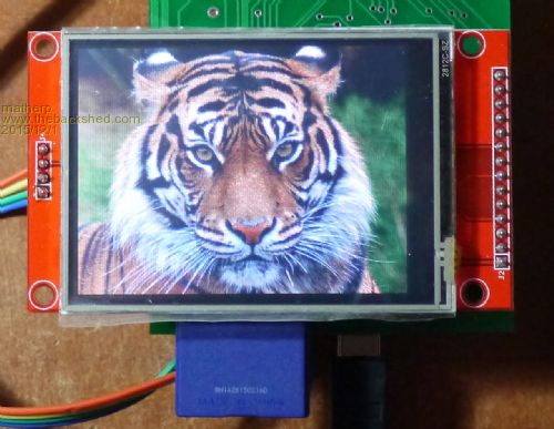

The first demo program contains the code to write an image saved as a binary .PPM file to a ILI9341, ILI9163 or ST7735 display. The tiger image saved as a .PPM is included in the ZIP.

  Quote  It is not enough to rewrite the relevant references, and recompile all C function?
Not quite that simple as the code must behave correctly relative to the other uses of the SPI port.
Anyway I've now made the changes by including some conditional compilation in the C code
2015-12-03_175102_SDCardV102.zip
This has also required making some changes to the picture drawing routines as they were previously holding TFT-CS low throughout the drawing whereas now this has to be toggled to allow interleaved SD card access to the SPI bus (C code also attached below).
The complete example code for the standard SPI ports to display an image is below.
drkl: Note that this code includes what you asked about in the other thread. i.e. it has a CFunction that can write out a full colour bitmap. The usage should be clear from the example. First define the screen region and then send repeated strings containing the RGB information for each pixel as 3 byte per pixel, top left to bottom right. In the example I repeatedly read 255 bytes from the SDcard (255 / 3 = 85 pixels) and then use the "DisplayBuffer" routine to write these to the display.
All: The SDcard CFunction for SPI2 is unchanged from V1.01 above. However, you should use the new display routines for loading pictures as they are better "behaved". Note that the "CompleteDisplay" routine is no longer needed as TFT-CS is now released at the end of each call to "DisplayBuffer"

Dear Matherp,
Thanks to the modified program, it works perfectly. The tiger is beautiful. My question is to be used for data collection purposes is the same solution. I apply given the SPI2 solution using BASIC program if the replaced part C function? I'm sorry, but I can not in C programming.
Thanks,
drkl

Dear Matherp,
I tested the programs, but I have a problem:
Here is the begin of the testprogram:
option explicit
option default none
' Version to use the standard SPI port on the Micromite
DIM I AS integer, P$(20) AS STRING length 20
const mount=0
const fileopen=1
const readfile=2
const writefile=3
const SD_CS = 4
P$(1)="tiger2.ppm"
P$(2)="chipcad.ppm"
P$(3)="tiger2.ppm"
P$(4)="chipcad.ppm"
cls
do
FOR I=1 TO 4
CLS
VETIT P$(I)
pause 2000
NEXT I
loop
SUB VETIT K$
? "IN: ",K$
displaypicture(K$,0,0)
? "OUT: ",K$
END SUB
and the result:
> RUN
IN: tiger2.ppm
OUT: iger2.ppm
IN: chipcad.ppm
OUT: hipcad.ppm
IN: tiger2.ppm
OUT: iger2.ppm
IN: chipcad.ppm
OUT: hipcad.ppm
IN: iger2.ppm
The first characters are vanished! (displaypicture is wrong?)
where I made a mistake?
drk

Posts: 11894
Posted: 12:04am 09 Dec 2015
The fileopen call in the CFunction converts the Basic formatted string into a "C" formatted string. I could fix this but it just adds code.
The workround is to copy the filename into a scratch variable before calling displaypicture
FOR I=1 TO 4
CLS
scratch$=P$(I)
VETIT scratch$
pause 2000
NEXT I
  Quote  A new problem:
