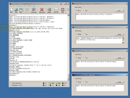

Here is my "proof of concept" code from a uMite connected to a ESP8266. The code "randomly" ? responds to the ESP requests for data + command field. In this test the ESP8266 responds with NTP clock data , status info and sends an email with data provided by the uMite. The uMite can ofcourse update its internal clock with the NTP data. 10 fields of data are also sent at each transfer in my case they will be garden data from my Greenhouse, Weather station and Solar PV generation. A very simple web interface in the ESP displays the "Garden" data but could also be sent to IOT etc.
Emails will be able to provide status update.
uMite test bed code below and Esp8266 code link was in previous post
' 'Test bed for ESP8266 Wifi module connected to uMite
' M.Ogden Nov 2015
randomize 1
Open "Com2:9600, 1024" As #1
'Open "Com1:115200, 1024" As #1
'clear the esp8266 input buffer
print #1,""
print #1,""
input #1, str$
Print str$
if instr(str$,"getdata:>") then
senddata
end if
sub senddata
emailaddress$="youremailaddress"
replyaddress$="yourreplyaddress"
'create a random value to select
getnewvalue:
randomValue = Int((3-0 + 1) * Rnd()) + 1
print randomvalue
if lastvalue=randomvalue then goto getnewvalue
select case randomvalue
case 1
strout$="Sync: 45.2:66:10:1008:17:89:12.4:19.2:106:89:info:"
print #1,strout$
print strout$
case 2
strout$="Sync: 30:62:10:967:17:89:12.4:19.2:106:89:ntp:"
print #1,strout$
print strout$
case 3
strout$="Sync: 36:56:10:1020:17:89:12.4:19.2:106:89:email:"
print #1,strout$
input #1, str$
Print str$
strout$="Sync: " + emailaddress$ + ":" + replyaddress$ + ":test from ESP8266:Hello, test sent from ESP8266:"
print #1,strout$
print strout$
case 4
strout$="Sync: 23:66:10:1008:12:56:12.4:19.2:106:89::"
print #1,strout$
print strout$
case 5
case else
print #1,"nothing"
end select
End Sub

Hi Jim, all the code was just a test routine to respond to the requests from the ESP each time with a different set of data and command, for testing purposes, the #4 is just showing that just data can be sent without a command. Currently I had only coded the three commands in the ESP but there will be others, IOT comes to mind but also some setup instructions for the ESP perhaps. Sending them sequentially with each set of data keeps the communication with the ESP simple as the Input command on the ESP is rather basic, no timeout (I have suggested this to Mike) for instance so if the data stream is missing its sits forever! until it receives something. This is why the single string consisting of a load of fields is better as it removes any syncing issues of individual fields, if one gets missed being received or are out of sequence being sent.The number of fields that can be sent are only limited by the string length in the esp but I am guessing its 256 bytes perhaps, the parsing routing will handle it. The string must consist of the first field in the "Sync: " format the space is important or the first "real" field will not be resolved properly, the ":" is used as the delimiter of course and the last char following the command field must be a ":" plus Cr/Ln, that's the whole data packet. Incidentally when working with the ESP code I found it useful to just use a comms editor. I used a program called CoolTerm excellent as it has a very nice send string capability that you can set up with different strings and select them as needed. I have a screenshot of when I was using it,
I will post more as the integration develops. Mike

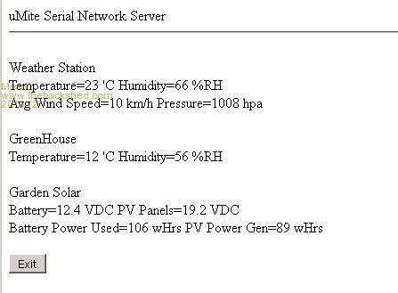

I have just posted my completed software for this project on ESPBasic which I have repeated here.
I have now completed a working version of the ESP8266-MCU Web interface. The following functions are provided.
Multi data field output, software captures these fields from the MCU and makes them available to the WEB GUI, current software has 10 fields but more or less may be configured
Format, sync: field1:------field10:cmd:crlf
A command may also be sent on its own line as cmd:crlf
Commands are in the following format
"Send Email" email:crlf then on the next line sync: to_address:reply_address:subject:body:crlf
"Send Thingspeak data" ts:crlf then on the next line sync: key:fieldnumber:fielddata:crlf
"Change Network" net:crlf then on new line sync: name:pasword:ip:gateway:mask:crlf
"Network Time" ntp:crlf requests NTP time info
"ESP System info" info:crlf requests system information network name,IP,freeram,freeFlash
"ESP reboot" reboot:crlf restarts the ESP8266
"ESP quit" quit:crlf quits the ESP software, useful during development.
A constant stream of information is sent from the ESP including responses to above commands , this data may be parsed by the connected MCU.
This software needs ESPbasic 1.65 or greater, needs new serial port commands.
Thanks to Mike for ESPbasic and being extremely responsive to change requests.

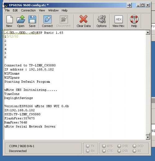

memclear
serialprintln ""
serialprintln "uMite WUI Initialising......"
ver$ = "ESP8266 uMite WUI 0.8b"
'connect "Network" "password" "IP"" "gateway" "mask"
'baudrate 38400
serialflush
serialtimeout 3000
timesetup(11,0)
setupemail "mail.smtp2go.com" 2525 "youraddress" "password"
gosub [getinfo]
let otemp = 23.3
let ohum = 78
let ows = 10
let opres = 1008
let gtemp = 23.3
let ghum = 78
let bv = 12.6
let pvv = 18.6
let bp = 120
let pvp = 90
'put your web GUI code here
cls
wprint "<head>"
wprint "<meta http-equiv='refresh' content='15;URL=/input?'>"
wprint "</head>"
print "uMite Serial Network Server"
print
wprint "<br>"
wprint "Weather Station"
wprint "<br>"
wprint "Temperature="
wprint htmlvar(otemp)
wprint " 'C "
wprint " Humidity="
wprint htmlvar(ohum)
wprint " %RH"
wprint "<br>"
wprint " Avg Wind Speed="
wprint htmlvar(ows)
wprint " km/h"
wprint " Pressure="
wprint htmlvar(opres)
wprint " hpa"
wprint "<br>"
wprint "<br>"
wprint "GreenHouse"
wprint "<br>"
wprint htmlvar(gtemp)
wprint " 'C "
wprint " Humidity="
wprint htmlvar(ghum)
wprint " %RH"
wprint "<br>"
wprint "<br>"
wprint "Garden Solar"
wprint "<br>"
wprint "Battery="
wprint htmlvar(bv)
wprint " VDC "
wprint " PV Panels="
wprint htmlvar(pvv)
wprint " VDC"
wprint "<br>"
wprint "Battery Power Used="
wprint htmlvar(bp)
wprint " wHrs "
wprint " PV Power Gen="
wprint htmlvar(pvp)
wprint " wHrs "
wprint "<br>"
wprint "<br>"
button "Exit" [quit]
timer 6000 [update]
wait
'end of GUI code

If all your hardware it set correctly you should see all the boot up and initializing messages on your terminal. Like this...
If you get this then all is good!

Now you can start sending data and commands via the terminal program. On a new line type info:crlf and the response from the ESP8266 will be,
Command:
getdata:>
info:
info: LineLen:6
Packet:info: info
Command:info
Version:ESP8266 uMite SNS WUI 0.6b
IP:192.168.0.102
SSID:TP-LINK_C95080
FlashFree:357675
RamFree:7200
likewise if you type ntp:crlf
Command:
ntp:
getdata:>
ntp: LineLen:5
Packet:ntp: ntp
Command:ntp
NTP:Thu Dec 10 13:47:49 2015
To send an email (provided you have to set up the emailsetup command in the program).
type...
email:crlf
sync: mike@codenquilts.com.au:mike@codenquilts.com.au:test from ESP8266:test:crlf
and the response will be something like this.
email: LineLen:7
Packet:email: email
Command:email
getemail:>
sync: mike@codenquilts.com.au:mike@codenquilts.com.au:test from ESP8266:test: Send to:mike@codenquilts.com.au
connected
220 mail.smtp2go.com ESMTP Exim 4.86 Thu, 10 Dec 2015 02:57:05 +0000
Sending hello
250-mail.smtp2go.com Hello 1.2.3.4 [203.147.99.198]
250-SIZE 52428800
250-8BITMIME
250-DSN
250-PIPELINING
250-AUTH CRAM-MD5 PLAIN LOGIN
250-STARTTLS
250-PRDR
250 HELP
Sending auth login
334 VXNlcm5hbWU6
Sending User
334 UGFzc3dvcmQ6
Sending Password
235 Authentication succeeded
Sending From
250 OK
Sending To
250 Accepted <mike@codenquilts.com.au>
Sending DATA
354 Enter message, ending with "." on a line by itself
Sending email
250 OK id=1a6rPr-kaUEES-9u
Sending QUIT
If you follow this you should get the idea how to use the ESP program when connected to a Mite! Let me know how you go on.
