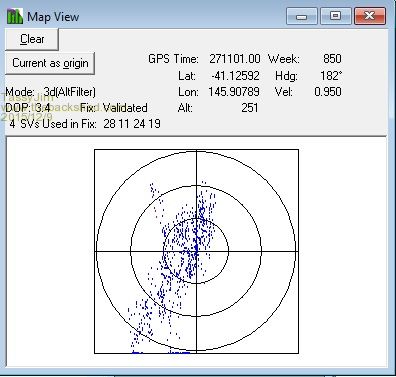

On page 67 of the users guide is this:
  Quote  Enable Track Smoothing
Enables smoothing of the calculated positions based on acceptable variances from the last calculated position. This assists in eliminating any sporadic position jumps possibly caused by multipath, for example.
Santa delivered my VK16E today so I will give it a try.
Posts: 6607
Posted: 05:06pm 08 Dec 2015
Page 71 of the users guide:
  Quote  Enabling/Disabling the Static Navigation
The steady state detection allows the navigating algorithms to decrease the noise in the
position output when the acceleration is below the threshold. This reduces the position
wander caused by Selective Availability (SA) and improves position accuracy
especially in stationary applications.
To select the static navigation mode:
1.Select Static Navigation from the Navigation menu.
The Static Navigation screen is displayed.
2.Select the option that you want to use.
3.Click Send to accept or Cancel to exit.
Note – The Static Navigation filter is Disabled when DGPS corrections are used in the navigation solution.
It did the job for me.
To use SRIFdemo, click on Action/Synchronise protocol and buad rate.
This should put it in SIRF mode.
Remember to switch it back to NMEA before exiting.

Posts: 2552
Posted: 06:14pm 08 Dec 2015
brilliant TassyJim, the last two posts did the trick!

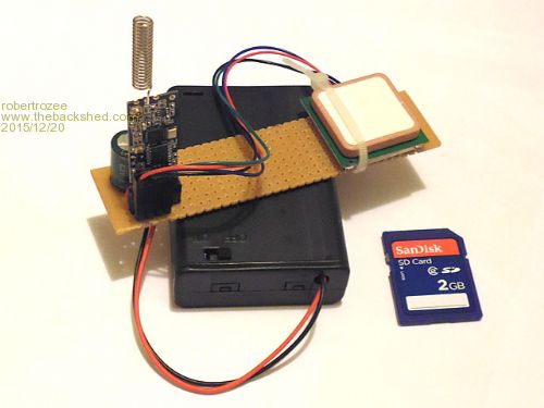

btw, i'm mulling over doing an SC construction article on differential GPS. essentially, while the GPS location of a single receiver wanders around, the difference between two GPS receivers close by provides a far greater accuracy. i want to see if i can get down to sub-centimetre resolution.
rob :-)
