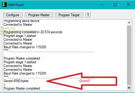

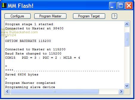

MMflash
A wrapper for pic32prog.exe
Pic32prog is a flash programming utility for Microchip PIC32 microcontrollers by Serge Vakulenko
The ASCII mode was added by Robert Rozee.
https://github.com/sergev/pic32prog
The ASCII mode made it possible to use a low cost Arduino or Micromite to program PIC32 chip without the need for MPLAB and a Pickit3.
Peter Mather wrote the CFUNCTION to allow the micromites to be used and Geoff Graham gave us MMBasic.
This wrapper is the easy part.
Unzip the files into any writable folder. MMflash write to the folder so it must have write permissions. "Program Files" is not a good location.

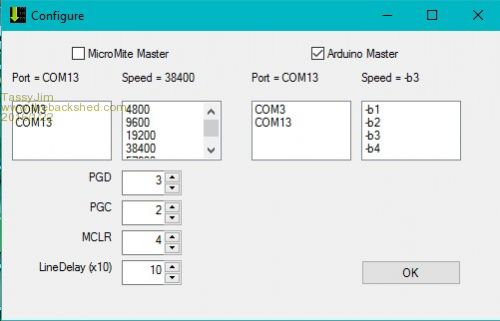

Configure.
For Micromites, select the com port and baud rate that it is currently set at. The baud rate gets changed to 115200 during programming.
You also need to set the pins that are used for the 3 functions
PGD, PGC and MCLR.
The line delay is needed during uploading the program. 10 (100ms) is the minimum that works reliably.
For Arduino, usually the only setting is com port. -b3 is the most common setting for baud rates but you may have to try other settings.
The settings are saved between sessions.

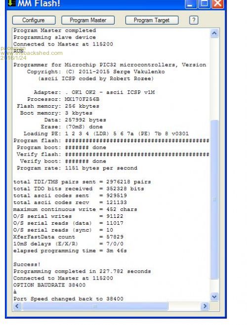

Programming the Master PIC
For the micromites, a successful load is indicated by the 'SAVED xxxx bytes'
If you don't see this, it is worth trying again.

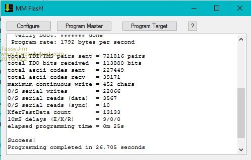

For Arduinos the programming is much faster.
Flashing the target PIC
Select the HEX file and sit back.
Windows only. Once the configuration is set, you can create a desktop shortcut and drag a HEX file onto the shortcut. MMflash will open and, after confirmation, start the flash process.
Windows: MMflash.zip
Linux 32bit: MMflash32.tar.gz
Linux 64bit: MMflash64.tar.gz
Help file: MMflash.pdf

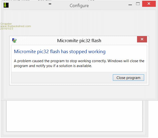

@ Jim - sorry about this, but:
- Fire up MMflash
- Click on CONFIGURE button
- Click on Arduino Master to put the tick in that check-box
- Click OK
- Click CONFIGURE button again - Crashes here.
Posts: 6607
Posted: 12:25pm 23 Jan 2016
Didn't you read the subject title "Flashing made easy"
I have tried to reproduce the error on a couple of different PC's without any joy.
I assume you are running W8 or W8.1 - I don't have either of those anymore.
Where did you install the files to ?
You shouldn't have a MMflash.inf file yet.
If you do, can I see the contents.
If you don't
Start MMflash and then close it.
That should create the MMflash.inf file.
Did you have the Arduino plugged in during configure?
MMflash looks for any existing and available ports. If there aren't any, a message should pop up. This takes a few seconds but closing 'configure' befre it has finished searching doesn't seem to matter.
I had better ask, what antivirus do you run?

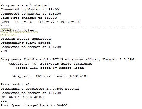

Hi Tassy
Great work but I have a problem?
The configure works
Program master seems to work
Program target does not this is what I get after doing all the above...
it has an error -1 and only takes about 0.5 secs
Any advice
32bit win7
Cliff
Cliff
Posts: 6607
Posted: 06:28pm 23 Jan 2016
The line with
"Adapter: . OK1 OK2 - ascii ICSP v1M"
tells us that we are talking to the CFUNCTION OK.
I suspect that the connection between the Master and Target is not correct.
PIN numbers wrong, no ground or no power.
Just tested with the Target not connected and I received the same messages here.

It looks like we didn't get a command prompt when first connecting.
I have done an update to the program to give some more feedback (and a couple of cosmetic changes).
A correct Program Master should now look like:
Program stage 1 started
Connected to Master at 38400
OPTION BAUDRATE 115200
Connected to Master at 115200
Baud Rate changed to 115200
COM13 PGD = 3 : PGC = 2 : MCLR = 4
Saved 6606 bytes
Program Master completed
I have added a crtl-C and more delays.
The first ">" is new and if not present, we are not talking to the 'mite.
You can download the full ZIP again or just change the EXE with the one in this attached.

Posts: 10044
Posted: 08:07pm 23 Jan 2016
  TassyJim said   Didn't you read the subject title "Flashing made easy"
Yeah, so?
  TassyJim said  I have tried to reproduce the error on a couple of different PC's without any joy.
Installed to C:\MMflash
  TassyJim said  You shouldn't have a MMflash.inf file yet.
I do.
Here it is(in a code box):
[Windows]
; Main Window
MainX = 200
MainY = 200
MainW = 468
MainH = 287
; Config Window
ConfigX = 200
ConfigY = 200
ConfigW = 500
ConfigH = 290
[micromite]
uM comport = com7
uM SerialSpeed = 38400
LineDelay = 150
PGD = 3
PGC = 2
MCLR = 4
[Arduino]
A comport = com7
A SerialSpeed = -b3
[General]
Master Device = micromite
MM Program = pic32prog.bas
HEX File = *.hex
HEX Folder =
  TassyJim said  Did you have the Arduino plugged in during configure?
No. I will try that first, and let you know.
  TassyJim said  I had better ask, what antivirus do you run?
AVG Free 2016, up to date.
Posts: 10044
Posted: 08:17pm 23 Jan 2016
UPDATE:
Makes no difference if I have the Arduino plugged in or not, although MMflash DOES correctly see it there as COM5.
Here is a short video showing start to finish and the crash.
There is no sound on this video, it is silent.

Posted: 02:25am 24 Jan 2016
Hi Jim - another great utility for the Micromite. Thanks for your efforts, and of course Jim, Peter and Serge as well - we're all going to enjoy this.
I downloaded your original MMFlash onto my old WinXP system last night and have just successfully flashed one of Mik's SMD MX170 Backpacks via another MX170 with MM2 V5.1 loaded. The steps were:
1. Flashed a new MX170 with the MM2 V5.1 software using my Pickit3.
2. Ran MMFlash from the folder that it unzipped into, without anything connected. Then closed it so that it set up the config.inf file into that folder.
3. Wired everything up: i.e. the XP notepad via a USB/serial converter and the console to the MM2 V5.1 Master - and the Master to the Target MX170 (one of Mik's SMD Backpacks). I used the same pins you showed in the screenshot of your first post for MCLR, PGD & PGC to the Backpack ICSD pins. Power and ground of the ICSD connector were connected from the Master MX170's supply.
4. Ran MMFlash again, entered the correct COM port number and the baudrate to 38400. (I put it in the wrong MMFlash box to start with )
5. Hit the "Program Master" button and got the output in first screen below. (I think I may have had to hit the "Configure" button again before I did this, but can't remember).
6. Hit the "Flash Target" button, navigated to where I had the MM2 V5.1 .hex file when it asked for it and away it went.
paceman
Joined: 07/10/2011
Posts: 1329
Posted: 02:42am 24 Jan 2016
I missed Jim's post above about pin 26 on Mik's Backpack. I had already (some months ago) disconnected the diode's connection to pin 26 - so that might be Rob's issue.
Greg
