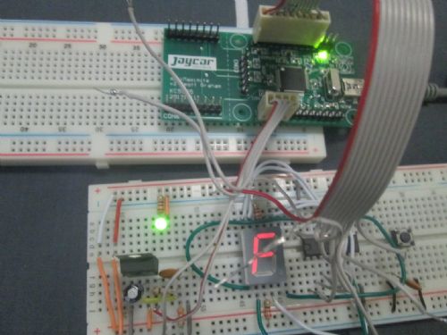

I have a momentary push button connected to the earth with a 100n cap connected in parrellel with it as shown in this pic...
In MMbasic 4.5 when I specify
setpin BUTTON, DIN, PULLUP, OnButton
it doesn't reconize the PULLUP keyword, so I have omitted it..
When I wave my hand over it from about 10cm above it.. it will activate the OnButton interrupt and run that code... I haven't even pressed the button...
Oh yeah the code I used is
setpin BUTTON, INTL, OnButton
any ideas on how to fix it?
Thanks for the replies

Hi Troyfa,
you MUST use a pullup!!! It's equal if you use the internal one or if you connect a external pullup! Try a 10K to 3V3. Your signal line is floating and reacts in other respects to your hand or similar disturbances.
Frank

As Frank says you need an external pullup. The programmed PULLUP etc. option is also not available in the Minimite (actually called the Mini-Maximite) or the Maximite, i.e. the MMBasic used for the MX695 and MX795 chips. It is only available for the later Micromites, i.e. the MMBasic running on the MX170 and MX470 chips (and a couple of others).
When you downloaded MMBasic V4.5 did you also download the manual? The later versions of the Maximite/Mini-Maximite software had two manuals, one for hardware and one for software. The MMBasic V4.5 software manual is called the "MMBasic Language Manual". There are quite a few differences to MMBasic for the Micromites that you'll need to know.
BTW, your bottom line of code looks fine for V4.5
