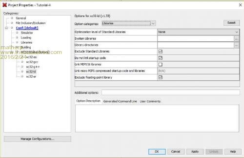

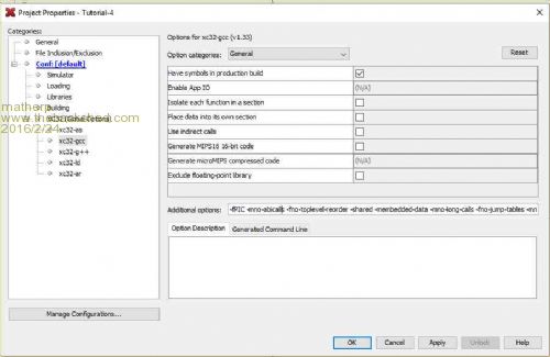

So lets start with the key setting we need to make inside MPLabX to use the new features. The project compiler setting just got complicated but it is just a string that needs copying and pasting into the compiler additional options
The full string is:
-fPIC -mno-abicalls -fno-toplevel-reorder -shared -membedded-data -mno-long-calls -fno-jump-tables -mno-jals -mgpopt -Wuninitialized -Wunused-variable -Wunused-value -Wunreachable-code
Remember to make sure the optimisation is set to 1, this is on the dropdown on the "Option categories"
Next we need to set the linker options as follows:
Note that "Exclude Standard Libraries", "Do not link startup code" and "Exclude floating point library" are ticked on the "Libraries" option category.
These are things we only need to do once and if you copy projects as explained above they will already be done for you in the new project.

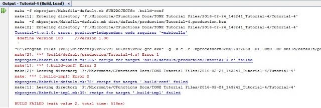

Are only the compiler setting changes sufficient to make use of switch/case? I can not seem to get switch/case to work in a CSub. Strangest part is the routine with the switch/case added, results in a smaller CSub.
  matherp said  -fPIC -mno-abicalls -fno-toplevel-reorder -shared -membedded-data -mno-long-calls -fno-jump-tables -mno-jals -mgpopt -Wuninitialized -Wunused-variable -Wunused-value -Wunreachable-code
Posts: 11889
Posted: 10:51pm 25 Feb 2016
  Quote  Are only the compiler setting changes sufficient to make use of switch/case?
Yes
  Quote  I can not seem to get switch/case to work in a CSub.
Without seeing your code it is difficult to see what is wrong. What are the symptoms? Before the compiler switch changes you would have seen a processor exception. If you are not getting this it is probably just a coding error

Posted: 12:30am 14 May 2016
Hi,
I think this might be a question for matherp, but others may also know the answer.
I am a newbie to PIC32 programming (although not programming per se) and to this forum and am trying to get an understanding of how to program CFunctions. I have downloaded the two zip files from the first post in this thread (the Tutorial-4 and the CFunctions.h zips). I have also installed MPLAB X IDE v3.26 and MPLAB XC32 C Compiler v1.40 (free version) from the Microchip website.
I was following through the steps in the first post and located the various settings referenced - all were set as described. I then tried to do a build (Run | Build Project menu selections) and got the following errors reported. Not being familiar with this compiler I am not sure what it is trying to tell me. It looks like the 2nd, 3rd and 4th errors are just flow-on from the first which appears to be the real culprit. I see in the listed set of compiler options there is a "-mno-abicalls" (this is in accordance with the notes in the first post) whereas the error seems to be saying that "-mabicalls" is needed.
Have I done something wrong? Has the compiler changed since the first post in this thread or what?
Thanks, Phil.
Posts: 11889
Posted: 12:41am 14 May 2016
Phil
Geoff and I both use compiler version 1.33. Please try that and then see if it solves the problem.
Please find attached the complete project for the SDcard routines which definitely works on 1.33
2016-05-14_111424_FileRead.zip Edited by matherp 2016-05-15
erbp
Joined: 03/05/2016
Posts: 195
Posted: 01:28am 14 May 2016
Peter,
I installed compiler v1.33 and Tutorial-4 builds successfully now.
Thanks!
Phil.
