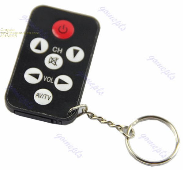

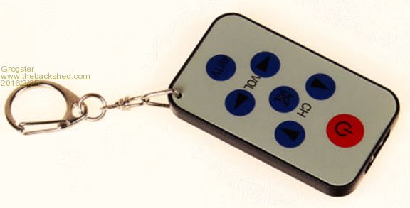

This thread might be of interest to some, but probably CG(CircuitGizmos), as I know he has some of these remotes.
After a bit of tinkering around, I have these remotes working well with the MM.
They are extremely cheap, averaging US$1 on eBay..

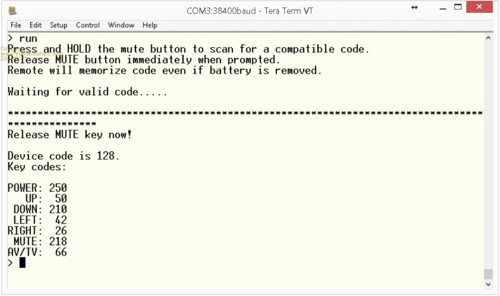

They are a universal remote designed for TV use, and thus, they can output many different codes. In my case, I found a device code and keycode combination that seems to work well, and then wrote a very simple code to allow you to search for the correct settings in the remote, without having a TV set to experiment on.
The code will prompt you of what to do, and all you have to do, is follow your nose.
I have run the code several times, and the keycodes always come out the same, so I think I have it such that the codes will be consistantly correct from this remote, but this code should be treated as alpha, and the idea as experimental.
I have tried this with both 38kHz and 40kHz IR receivers, and both work fine.
The 40kHz receiver gives best range, so I think we have hopped onto a Sony frequency - that or this is just good luck.
REMOTE LEARN CODE:
IR DevCode, KeyCode, IR_Int
Print "Press and HOLD the mute button to scan for a compatible code."
Print "Release MUTE button immediately when prompted."
Print "Remote will memorize code even if battery is removed."
Print
Print "Waiting for valid code....."
Print
If DevCode=128 Then
Print
Print "Release MUTE key now!"
Print
Print "Device code is 128."
Print "Key codes:"
Print
Print "POWER: 250"
Print " UP: 50"
Print " DOWN: 210"
Print " LEFT: 42"
Print "RIGHT: 26"
Print " MUTE: 218"
Print "AV/TV: 66"
IR Close
End
EndIf

This code is nothing fancy at all, but it will help you setup the remote with very little pain.

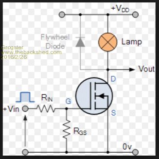

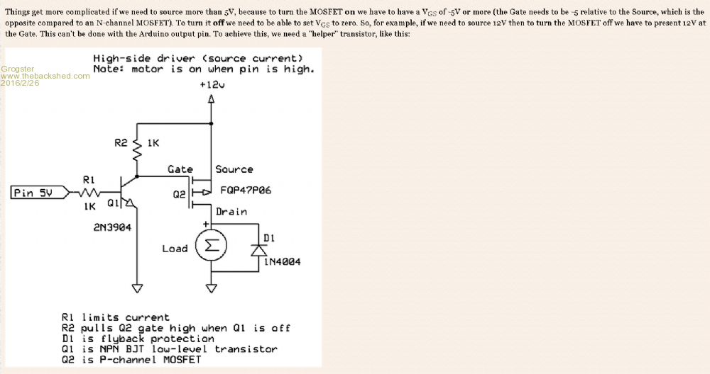

As WW says, MOSFET's are gate things when you get used to using them.
Pun intended......
Low-side N-channel MOSFET switching is dead easy, but high-side P-channel switching almost always needs a blower transistor to help the gate along.
Low-side switch:
...and high-side switch with blower transistor:
Either of these will do equally as well as the relay, use less power to operate, and can pass surprising amounts of current with very little heat dissipation - that's one of many of the beauties of MOSFETS.
