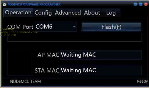

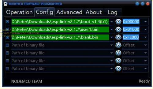

Once you have downloaded the Wifi/Uart binary run the NodeMCU Flasher and set up the three bits of the binaries to be flashed on the "Config" tab
The instructions on Github are quite good but miss the issue of where to load "Blank.bin". On a 1MB ESP load it to 0xFE000. On a 2MB version use 0x1FE000. On a 4MB one use 0x3FE000. I haven't tried using one of the early 512MB ESP8266.

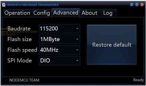

Set the Flash size on the "Advanced" tab. The ESP8266 will automatically adjust to the baudrate set but 115200 works well
Finally, go back to the "Operation" tab and click "Flash"

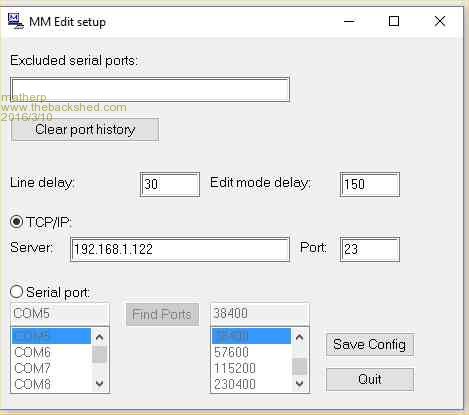

Then use your favourite console program (it is MMEDit I assume) and create a Telnet connection to the IP address that the ESP software reported. I then create a fixed IP allocation for the device's MAC address on the router so I know it will always be on the same address.
From then on you have normal console access to the Micromite as though it was wired via USB - excellent . Programs download from MMEdit just as normal allowing easy remote program update.

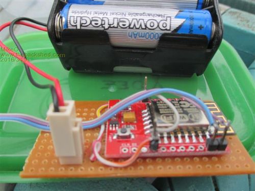

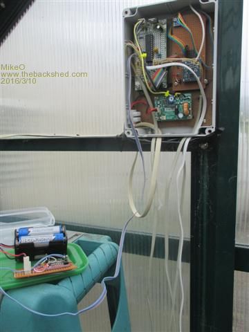

Totally agree with Matherp. I have been using this program very successfully for some time, see my earlier post. One caveat, whereas MMEdit chat communicates fine I usually use Teraterm in conjunction with MMEdit and I could not get teraterm to work reliably in this case (I have used teraterm over TCP/IP previously ok). In my post I do refer to another Terminal program I found however and it works very successfully it even has macros and file transfer so I am still able to use Tassy Jims excellent "Crunched" file transfers.
By the way if you still want to use 38000 baud you can set the serial rate in the ESP8266 programs Web page.
My unit in use on my weather station.
Mike

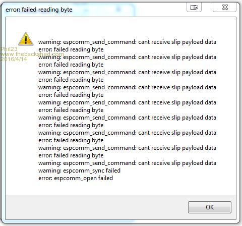

Tried to run ESP_Basic_Flasher.exe but it returns an error when I try to connect to com10:, error:espcomm_open failed.

Still having no luck with this.
Searched & read till my eyes are falling out.
Connected to a CP2102.
Appears as Com10: & have set it to 115k baud.
Powered with 3.3 volts.
TX & RX pins crossed.
CH_PD pulled high to 3.3v as mentioned elsewhere here.
Tried momentarily grounding reset pin as mentioned.
When I hit Flash, I get TX & RX activity on the CP2102
and a blue led flashing rapidly on the ESP8266.
After a period of time,
The programmer displays these messages in a slow loop:-
require("wifi")
require("gpio")
connect.world()
LED activity on the devices remains unchanged.
If I quit the programmer:-
I can see a Wifi point called "AI-THINKER-E10e07" as an available network.
I can connect to it & it provides my laptop with an IP address of 192.168.4.2 with a Gateway of 192.168.4.1.
If I try & open 192.168.4.1 in a browser & don't get anything.
Also if I try & run ESP_Basic_Flash.exe I get:-
Totally frustrating, having spent 30 years in IT, something that seems to be a handicap at times.
Cheers.
Edit:-
I do see a little activity frm the Blue LED on the ESP8266 when I attempt to run the Basic flasher.
Edited by Phil23 2016-04-15
Posts: 11873
Posted: 09:28pm 13 Apr 2016
You do have GPIO0 pulled low when programming and the remove the connection and reset afterwards?
Are you powering from the CP2102? That won't work - you need a really meaty 3.3V supply as the ESP8266 takes serious power intermittently when transmitting on wifi
