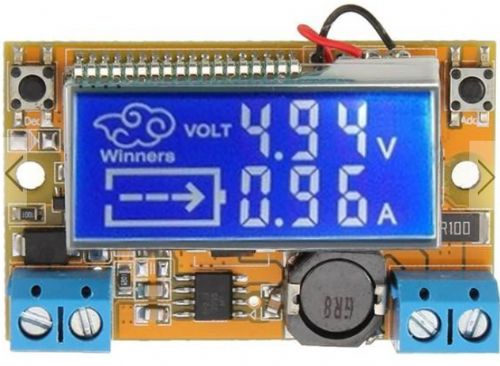

Hi All,
I have just found THIS Adjustable PSU on Banggood.com
It seems pretty impressive for $6.66AUS inc shipping..
It requires 5-23V (I suggest a 19V laptop power supply} and it offers 0-16.5V @3A (peak current so probably means continuous current at somewhat less than 3A)
Anyway for the price it looks OK.

I wish they provided a spec for ripple and noise, but one of us can measure that and report our findings. For the price I'll probably get one just out of curiosity.
My lab is brimming with an assortment of high grade voltage/current regulated supplies so don't need another, although this would be smaller than any of those, but switchers are not the best for general lab use either.
As far as this one lacking current limiting, as has already been stated, current limiting during development of projects is almost an essential. However, it might not be too big a deal, for those desiring current limiting even if it were fixed at 3 amps, to add that on as an outboard, optional accessory.

Whoever get their hands on one of these, please report the IC used, I would like to see the circuit diagram.

How about the best of both worlds?
Mick's LCD on different PCB with V and A adjustments
A little more expensive, yes, but that would be the one I would go for.
On-board USB sockets too, so you can easily use it for any USB thing - including the likes of the Micromites.
