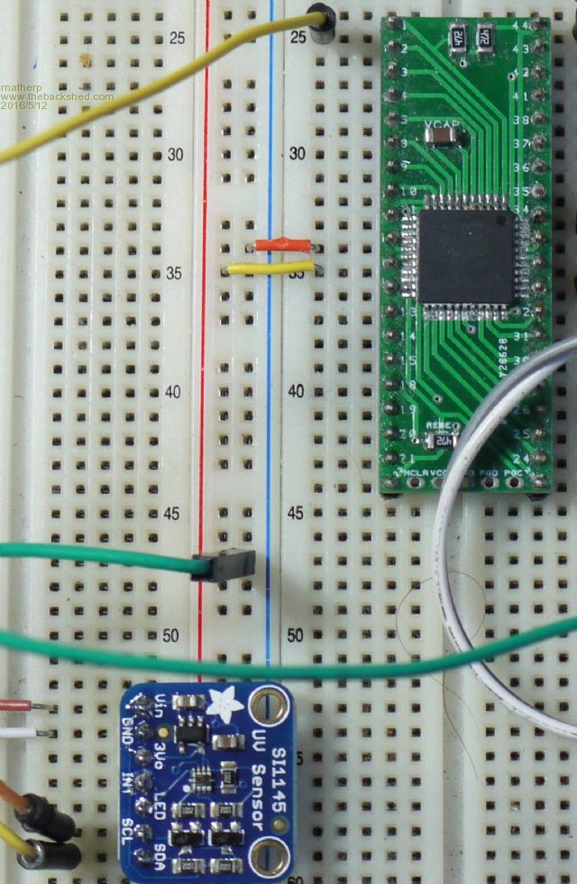

At lew247's request here is a simple 1:1 port of Adafruit's code for the SI1145 Digital UV Index / IR / Visible Light sensor

const SI1145_ADDR = &H60
' Main Program
dim float UVindex
i2c open 400,1000 'device will run at full speed
if(read8(SI1145_REG_PARTID)<>&H45) then
print "SI1145 not found"
else
reset_SI1145()
start_SI1145()

sub write8(reg as integer, myval as integer)
i2c write SI1145_ADDR,0,2,reg,myval
end sub
function read8(reg as integer) as integer
local integer i
i2c write SI1145_ADDR,1,1,reg
i2c read SI1145_ADDR,0,1,i
read8=i
end function
function read16(reg as integer) as integer
local integer i(1)
i2c read SI1145_ADDR,0,2,i()
read16=i(0) OR (i(1)<<8)
end function

Thanks :)
Hopefully I'll be able to sort it out myself from now on
