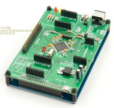

If you want to have a self contained computer then you have to use the Micromite Plus (MX470 chip).
Grogster has designed a backpack like PCB for the MM+ designed to fit on the back of a 5" SSD1963 display. This includes a keyboard interface so the whole thing can act as a self contained computer with SD card storage. I am currently writing an article describing it and it should appear in Silicon Chip (an Australian magazine) in a few months. This is a sneak preview:
Kon's School Laptop uses the same chip but is more sophisticated.
