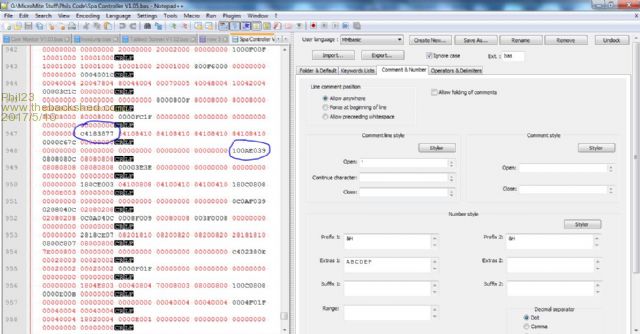

Posted: 10:56am 09 May 2017
Been playing with this on & off for a while now.
Slowly changing the User Defined language in Notepad++.
I've got a fair bit of it working.
Not sure how current the Keyword list is.
HEX numbers were a little tricky.
I haven't added all the delimiters & operators yet as it's still WIP.
The delimiters & operators are displayed in pink, only so I can see what's happening to the text etc on either side of them, helps with defining the language.
Only have the folder set for SUBs, FUNCTIONs, & SELECT CASE at this stage.
Haven't quite worked out how to get it all working in sync once I add IF's & LOOPs.
Multi line IF's has me a bit stumped.
If anyone wants to give it a try, just import the MMbasic.xml from the zip file into the Notepad's User Defined Languages.
Phil.

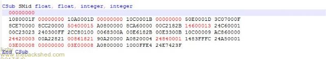

Posts: 3881
Posted: 12:49pm 09 May 2017
Ok, colors--thank you.
The only thing that jumps out at me initially is that in CFunctions, some of the numbers display in red and some in black.
MMEdit does the same, but different numbers are red. This is of no consequence to me.
I use npp a lot, so thanks for this.
Lance

Posts: 6607
Posted: 03:09pm 09 May 2017
That is something that is difficult to do anything about.
NPP looks at a 'word' and if it only contains numerals it is a number.
Added to that it can contain a sign '-' e for exponential and still be a number.
Depending on the lexer, HEX numbers will appear as a number but they usually need &h, 0X etc
In MMEdit, if the 'word' starts with a numeral it is treated as a number.
This means that a variable such as 1X will display as a number but X1 will display as a word.
The only way is to turn off colouring at the start of a cfunction and back on at the end.
That requires greater control of the Scintilla gadget that is doing the hard work.

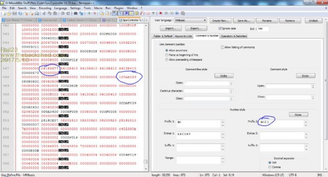

Posted: 12:26am 10 May 2017
  lizby said   Ok, colors--thank you.
That seems to be related to the "Prefix 2" in the numbers definition.
See in these examples, adding 0-F in this field should fix that bit.
Dunno if it will break it else where.
Phil.

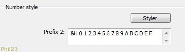

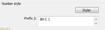

Phil23
Joined: 27/03/2016
Posts: 1667
Posted: 12:31am 10 May 2017
Not really readable above, but Prefix 2 needs:-
0 1 2 3 4 5 6 7 8 9 0 A B C D E F
In the above example I just added C & 1 after the &H for a test.
Phil
Phil23
Joined: 27/03/2016
Posts: 1667
Posted: 12:36am 10 May 2017
Updated XML file for the above change.
2017-05-10_103612_MMbasic.zip
Phil

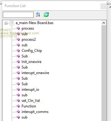

Does anyone understand "Parsers" well enough to be willing to have a look at getting the function list going in NP++ for the User Defined Language I've been posting?
There's an explanation on this page, about how to set it up, but I don't understand the syntax.
It also mentions that in the case of a User Defined Language, like mine above:-
[Code]if langID cannot be found above, you can set the file extensions ...
<association id="my_parser_id" ext=".my_parser_ext1" />
<association id="my_parser_id" ext=".my_parser_ext2" />
and for User Defined Languages (UDL's) use ...
<association id="my_parser_id" userDefinedLangName="My UDL Name" />[/code]
Having the Function List working would provide a huge editing advantage for MMbasic, and I presume the required Parser will only need about 3 keywords,
SUB, FUNCTION & SELECT CASE.
Phil.

Posted: 09:04pm 11 May 2017
Really Don't understand the XML here, but getting this result...
Notice it's picking up the End Sub & End Function words....
this is the Parser I'm using, wbut it's a bit out of my depth.
[Code]<function mainExpr="((SUB|FUNCTION)).*?(?:\(|$)" displayMode="$className->$functionName"> [/code]
Can anyone tell me how to make it ignore the END SUB & END FUNCTION lines?
This is the entire functionList.xml I'm working with ('we are hacking a VB section pasted near the end).
Would be great if someone could help out in getting the last step.
Phil.
Probably need my Language file from earlier in this thread.
2017-05-12_070330_functionList.zip
