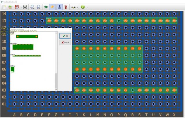

Look's like a great concept for lots of users who aren't into PCB design.
Will get my hands on a couple when they are available.
Especially like the ability to play with the layout in software, even though I had to use 2 DIP14's to represent a MicroMite.
Any Idea when they will be available?
And DIP28 added to the component library?

You can actually define your own components.
Select the component mode (the orange icon), right click and select "Add New Component". Then choose the one on top which says "BLANK", give it a name and place the holder somewhere on the board. Now you can add and remove pins within the component area, and you can drag the pins to change the component area. So you place 28 pins, give them names or numbers and then when ready right click again and choose "Add to Library".

Ahhh,
Thanks, didn't know the usage & saw that add to library was greyed out, so thought it wasn't implemented yet.

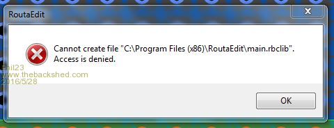

Error on add to library.
NTFS file permissions on C:\Program File(x86)?
Not usually writable by default,
but strange as I have full permissions to the file and have ownership.
Phil

Looks like that. Try to run the program as administrator
Will be fixed in the next revision

That's what I'd just been trying.
Worked fine.
