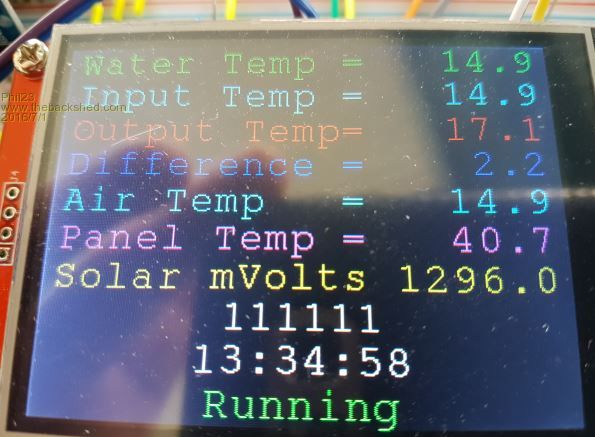

Hi All,
Does anyone have suggestions on how to test for Flags.
I'm currently setting 6 bits to indicate various status's of my water heating controller.
I'm using this Sub to set them:-

I want my control logic to make decisions based on these.
How would I test for given bit patterns like:-
????00, ignoring all but the first 2 bits.
or
00???111
There are certain things I need to ignore at given times, like input/output temp, which means nothing when runtime is less than 10 minutes.
Once it's running, solar level can be ignored, providing minimum Delta Temp is met.
This could typically but a day that's become overcast, but is still providing a certain degree of heating.

Yes Agree,
One of the reasons I decided to setup the Flags was so I could view some system status while developing the control logic.
Once I add the heat pump & motorised ball valves there will be a lot of status to monitor & observe.
Will really lend it's self to a graphical interface on a MicroMite Plus...
There are a few curly situations.
Like first thing of a morning, the input & output temp sensors are useless.
Right now (7:30am) I see current temp at 13.5°C.
Input at 6.3, Output at 9.4°C, both irrelevant temps based more on ambient influence.
They require about 8-10 minutes of runtime before meaningful data is returned.
Once Solar Volts reaches 350mV there is sun sufficient to begin heating the panels.
Once the panels are 5° above water temp the pump is started.
The other situation I've observed is that when it becomes overcast, Solar volts can drop well below 350mV, yet there is still quite a lot of energy present.
Enough to keep the panel above the water temp and temp out above temp in.
I know I'm trying to be greedy with the amount of heating I'm trying to achieve.
4,200kJ to raise 1000 litres 1°C.
I got 4° a few days back; 16,800kJ=4.7kWh=$1.13 on my current rate. $101.00 over the billing period. Pump run cost is 11c for 6 hours.
Back in Mid March, I was producing around 5kW hours with a single panel.
The 4.7kW hours earlier this week was with the current 3 panels.
All that said, I'm open to advice, very aware that some of my "Brilliant Ideas" have serious short comings.
PhilEdited by Phil23 2016-07-02
