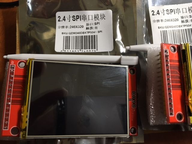

Heres a Pic of the PCB on the bad LCD's
Note the missing pin MISO pin this the fix that got it going.
The wire links are a result of my tests with a different touch panel
@disco4now yes this one also came with a little touch stylus
Jman

The two I have are the same as the picture above. I have snipped off the MISO pin and one is working OK now.
The second just shows the backlight and no display data as before, but the touch can be calibrated blind and prints back to the terminal that is done.
Thanks to Jman I have saved one.
I did notice when I just swapped the LCD into a setup that had the original type LCD setup that is worked but touch was mirrored left/right. GUI Calibrate fixed it, but seems this one and the original are reversed left/right
