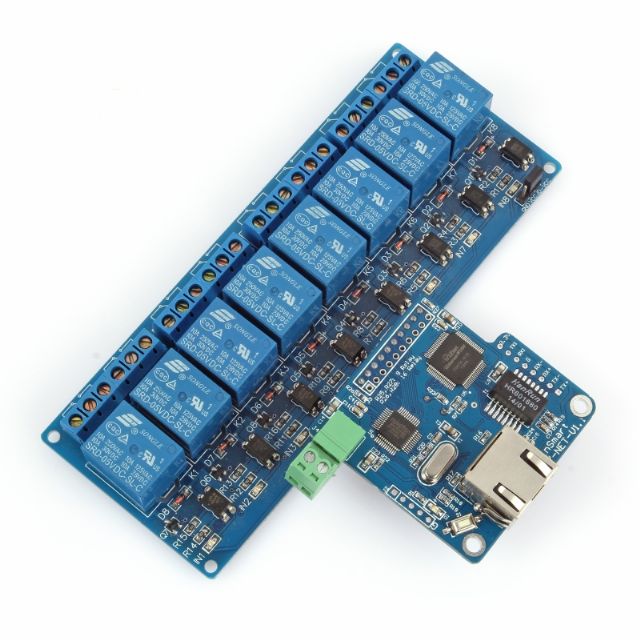

  SiNut said   Hi Paul,
I have used the MCP23S17 serial I/O expander to save pins on the processor. This device provides 16 I/O pins and its SPI interface requires four pins on the processor. The output of the MCP23S17 is connected to ULN2003A relay drivers. One expander and two of these relay drivers can handle up to 14 relays.
Is this something like what you are suggesting? I can't read the part numbers on this gadget. I don't know where this picture comes from or who sells this little board.

Hi Paul,
The picture you have attached shows a relay board that is designed to be controlled over the Ethernet. It is made by SainSmart and you can find more information here:
http://www.sainsmart.com/sainsmart-imatic-with-rj45-remote-control-8-channels-wifi-relay-kit-smartphone-android-ios.html
I would not recommend using an Ethernet interface as it will add unnecessary complexity to your system.
Using the I2C bus on the uM+ is a better choice. The MCP23017 I/O expander from Microchip will interface to the uM+ I2C bus and provide you with 16 additional I/O pins. With proper code on the uM+ the MCP23017 expander will operate these pins as outputs to drive the relays.
You can use two 8-relay board from SainSmart and connect each one to eight output pins of the MCP23017 I/O expander. Here is a link to the details on the 8-relay board from SainSmart:
http://www.sainsmart.com/8-channel-dc-5v-relay-module-for-arduino-pic-arm-dsp-avr-msp430-ttl-logic.html
The 8-relay board has the necessary circuitry on it to drive the coils of the relays and also provide optical isolation between its inputs and the relay drivers - an added bonus. There is no need the ULN2003A devices I mentioned in my previous message.
The input circuit of the relay board appears to be designed to operate on 5V. However the uM+ will be running at 3.3 volts as will the MCP23017. This lower voltage may not be sufficient to trigger the opto-couplers on the relay board. Short out the LEDs labelled IN1 on the relay board. This will eliminate their voltage drop from the input circuit and the opto-coupler will be able to operate with 3.3 volts input.
I hope this helps. If you need more details please let me know.

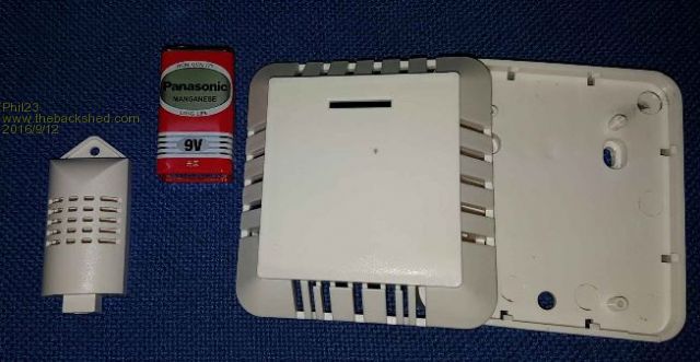

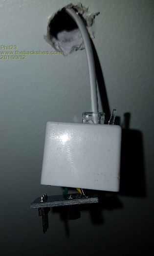

Hi Paul,
This post will give you a rough idea of how I'm connecting things.
It's really a mixed topology in my case, a mix of Star, bus & droppers.
I've also seen some 4 way splitters on ebay for a few bucks.
I've got enclosures to put the sensors in, they we a few bucks each also.
For the board end I think I'll cut off the RJ-12's & replace then with 3 pin polarised headers.
Like these.
Phil.
