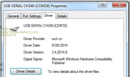

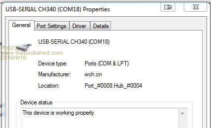

@Grogster, or anyone else?
Any Ideas what I might be doing wrong?
I don't have loop-back.
Win7 Pro.
[Code]G:\MicroMite Stuff\PicProg32>pic32prog -d ascii:com18 -b5
Programmer for Microchip PIC32 microcontrollers, Version 2.0.220
Copyright: (C) 2011-2015 Serge Vakulenko
(ascii ICSP coded by Robert Rozee)
Adapter: ::::::::::::::::::::
No response from 'ascii ICSP' adapter
No target found.
G:\MicroMite Stuff\PicProg32>[/code]
Phil.
atmega8
Joined: 19/11/2013
Posts: 738
Posted: 08:49pm 15 Sep 2016
Dont't enter threads ;-)Edited by atmega8 2016-09-17
Phil23
Joined: 27/03/2016
Posts: 1667
Posted: 09:06pm 15 Sep 2016

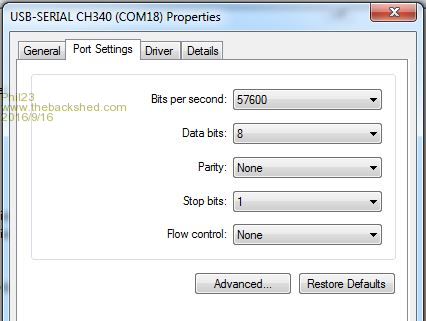

Should also add,
I can see activity on the TX & RX Leds on the Nano when I try & type something in Teraterm.
Just not seeing it looped back.
Edit:-
Seemed like I needed to change the Baud Rate to 57600 in Device Manager.
[Code]G:\MicroMite Stuff\PicProg32>pic32prog -d ascii:com18 -b3
57600 baud ... synchronized
Signature = 1e950f Device = ATmega328P
Firmware uploaded to 'ascii ICSP' adapter OK
Looks fine now.
Edited by Phil23 2016-09-17

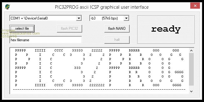

Posts: 10043
Posted: 12:07am 16 Sep 2016
Well done.
Yes, that is a bit of a catch-ya for the ASCII ICSP when you get your first one.
In order to upload the firmware to the Nano board, you usually have to set 57k6 or thereabouts baudrate, or it won't talk to it. From that point on, you should have no problems, and the ASCII ICSP does not care about the baudrate of the VCP once it is running - it will use whatever when it comes to using it to program PIC32 chips.
This information is in the manual that Rob wrote for this device, available from my website's download section and several other places.
I encourage you to use Rob's GUI for PIC32PROG, which makes programming chips a breeze:
Edited by Grogster 2016-09-17

Rob Rozee's GUI for PIC32PROG
