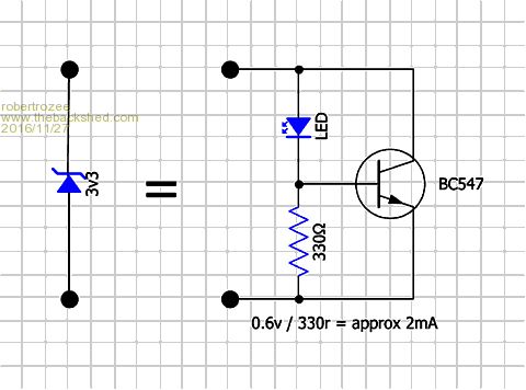

because it is a shunt regulator, the load (zener diode, pic32, or some combination thereof) needs to always be drawing 60mA. the only way to decrease this is to increase the values of the three 100 ohm resistors. but if you increase the values of the 100 ohm resistors, then you risk not having enough current to power the pic32 during programming.
i chose 60mA as being a safe compromise: microchip suggest the target should draw no more than 25mA, i read somewhere that the pickit2 can supplky at most 50mA, and the usb port is limited to 100mA in total.
any zener diode between 2v7 and 3v9 should be fine, or you can use a string of 4 or 5 silicon diodes in series. or, if you must, you can use an 'amplified zener' circuit:
rob :-)

Thanks for the response. I wanted to explore the possibility of using an LED in lieu of the 3V3 Zener so it would both regulate the voltage & give a visual indication. But it is not feasible as I can't find a Blue LED that can handle >50 mA.
The issue of the photo current would not be an problem since the current will go into the three 100 Ohm resistors in parallel. So the voltage due to the photo current would be about 10 uA * 33 = 330 uV.
So won't do anymore exploration, I'll use a 3V3 Zener.
