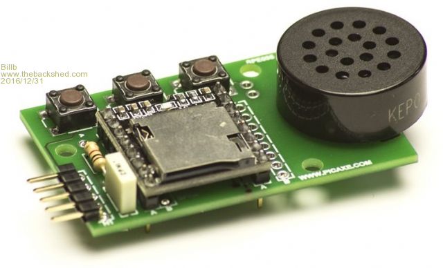

Hi Grogster
I have used the PICAXE SPE035 module in my robots with great success.
They are available for the Picaxe store for about UK 9.00
This is a video using a 170 to trigger the module.
https://www.youtube.com/watch?v=BNP2ViHBlGo
Sample code I used to test the messages for the robot
