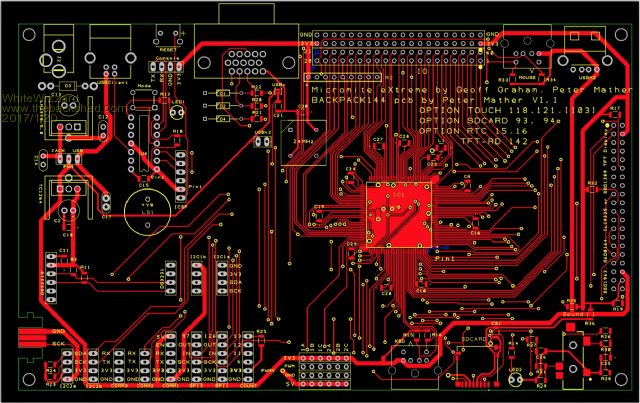

Hi Pierre,
Thanks for your continued loyal support for the Micromite; and also your interest in a Micromite eXtreme module. I will add your name to the ever growing list of interest in the 144-pin MM powerhouse!
The PCB is currently costing me £16 (each) to land in the UK (at low volumes).
Likewise, the 250MHz PIC is costing me £13 each (volumes < 25).
So for low volumes I anticipate a fully assembled unit to be approximately £85 (which is only £10 more than an assembled Explore 100 module).
However, if there is enough interest I can then sell for a slightly lower figure. So I may open it up for BackOrdering at £80 (and take a risk) to see if I can get another 11 people interested so that I can bulk purchase the PCBs and PICs.
If more than 30 additional people show interest then I can get it to below the cost of an E100; that would be the best scenario for everyone interested.
The new version of the MMX PCB has provision for direct connection of a Nunchuk controller. This allows things such as:
- controlling the mouse pointer with code (an idea thanks to MicroBlocks
- provides a great 'direction control' for things such as games (WATCH THIS SPACE - a classic is due for release along with this module)
- has a 3-axis accelerometer for movement/tilt sensing
- and has two buttons - allows you to 'trigger' MMBASICs TouchScreen controls (ideal on VGA)
The new PCB will also allow playback of 48KHz WAV files; and there are some more exciting 'hardware & software' features that Peter is currently working on . . . .
So if anyone else is interested then please do drop me an email/PM so that I can secure the lowest possible price for you all.
WW

@WW...
You can count me in also, if not already on the list..!!
Does the PCBA layout have mounting holes setup form the 7" display..?
If so, maybe I need to have 2 of the "Full builds"..
(mouth watering)...Edited by Zonker 2017-01-17

Hi Zonker - Yes the PCB has the 40-way female ready to accept the SSD. In fact the whole PCB is designed to 'bolt onto' the 7" SSD.
I will be able to offer 'custom' builds for any TBS members by the way - I just won't be supplying the TFTs initially due to the already low costs from China. If from the UK, then I have to charge shipping which then makes my cost seem high.
SO PCBs (and custom builds) on offer here to try get volume ordering from the suppliers . . . .
There has been a bit of interest since my post - so thanks to all that have been in touch
WW
