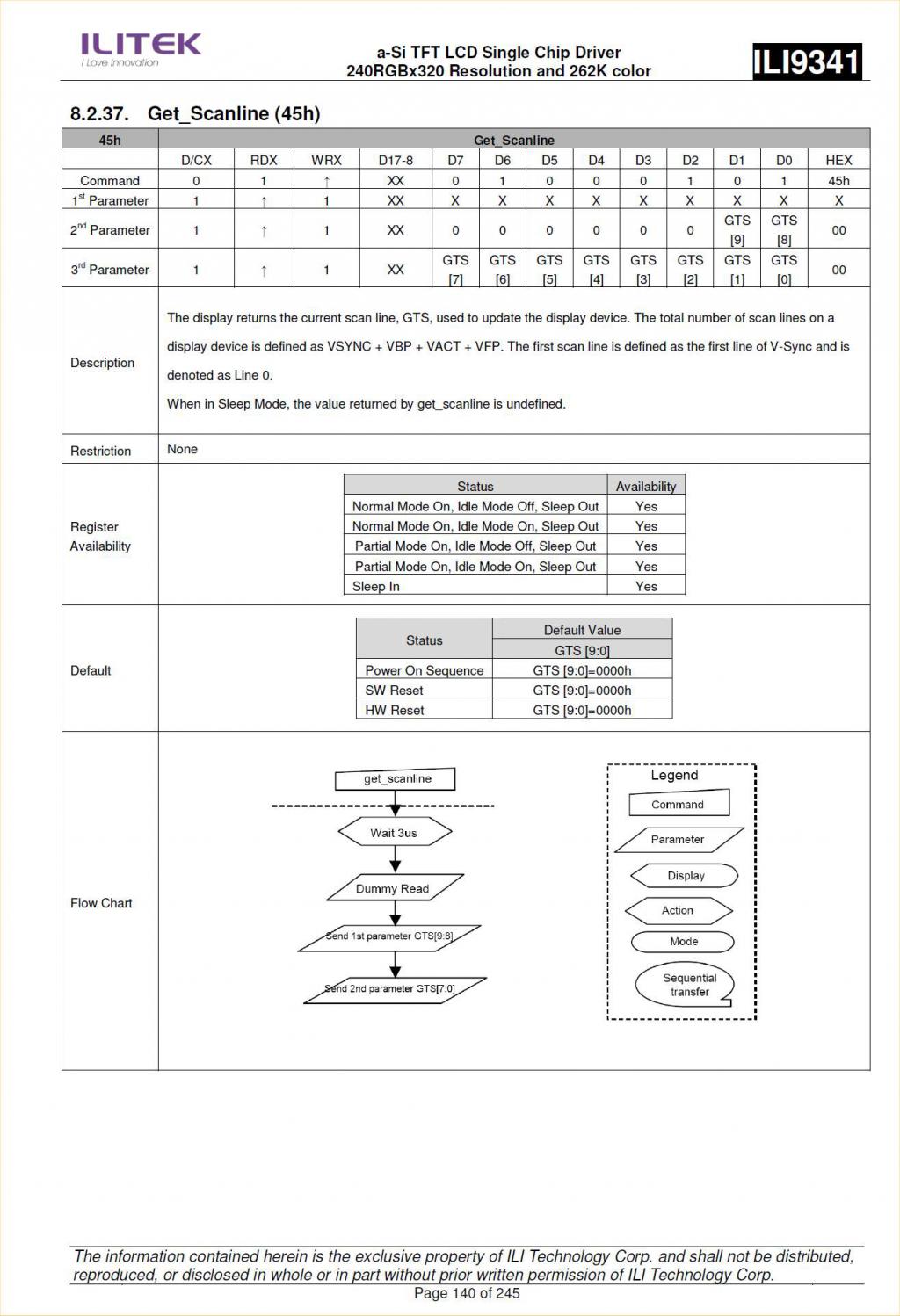

Posts: 11852
Posted: 08:32am 10 Oct 2022
  Quote  getscanline isn't relivent to a LCD display, so won't be in that version of MMBasic, LCDs are not scanned, at least not in the sense of a monitor or TV screen,
Actually, they are scanned exactly like a television. Most LCD controllers have commands to allow you to read the scanline. However, this can only be done if you can read from the display in the first place. So in PicoMite terms this would be on displays that support BLIT. ILI9341, ILI9488 (possibly), and SSD1963 could be possible but this hasn't been implemented.
Edited 2022-10-10 18:39 by matherp
