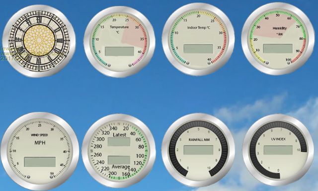

I've been studying the Blit command in the manual in relation to gauges
What I really want is someone to explain in detain exactly how the gauge program on this page works.
I can't get my head round understanding what is happening to make the needle in the first place, and also how to make it move,
Then I need to understand how the BLIT command works in order to incorporate both together.
I've spent hours studying the program but I cannot get it into my head how it works

What I want to end up doing is understand how the gauges actually work so I can add or delete gauges if I change the program/dials and also how to get the gauges to display the information I am going to send them
For example some of the gauges I will need to move 360°
some will need so move around 240° or maybe a bit more
You can get an idea of what I need from the picture below
IF anyone has the patience to try and explain it please.........

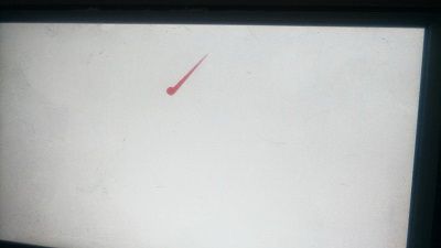

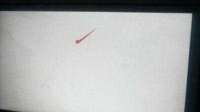

Posts: 11889
Posted: 11:16pm 21 Feb 2017

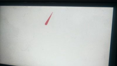

Lets forget CFunctions, we don't need them anymore, and make sure you have 5.3.02 loaded on a MM+. BLIT is then available on both the SSD1963 and ILI9341 displays if wired correctly (see the manual)
Make sure this is the case by loading an image and then typing
BLIT 0,0,100,100,100,100
The 100 by 100 square at the top left of the picture should now be replicated diagonally below and to the right
If this isn't the case you have a wiring issue.
Now study the attached program but also reference this thread which shows how a pointer is constructed from a series of triangles. Why triangles? Because you can draw a filled triangle in any orientation and of any shape.
A rectangular pointer is comprised of just two triangles like the centre two in the diagram in the previous thread. The example below uses four to make a more complex shape.
I've commented the program so it should be easy to follow what I am doing. At the simplest level adding multiple gauges and pointers is just a matter of replicating the code and data structures. In this case you would use a different BLIT buffer number for each pointer so they can be updated independently.

Posted: 05:55am 14 Aug 2017
I've got the dial working the way I want
However I have 2 problems
1: the dial "shrinks widthwise after a few seconds)
2: out of memory error after the gauge moves around 300 steps
The out of error message when the pointer stops moving is this
[code][115] Blit read #1, x, y, w, h
Error: Not enough memory
[/code]
Gauge (YouTube Link) showing the gauge working (no background picture at the moment*
This is the code
[code]

Anyone able to tell me why both errors are happening?Edited by lew247 2017-08-15
Posts: 11889
Posted: 07:05am 14 Aug 2017
You've got two versions of drawpointer in the code, one of which you seem to have tried to simplify to only dealing with one triangle but bits of it still expect arrays and getlimits still expects arrays. It needs a lot more editing to make it just deal with one triangle. Easier would be to define the pointer as two triangles and go back to the original code
lew247
Joined: 23/12/2015
Posts: 1709
Posted: 08:22am 14 Aug 2017
Thanks Peter I've modified the code again so it's definitely only using one "drawpointer"
The pointer crashes after moving 314 times
[quote][93] Sub drawpivot(offset%) 'put anything you like here to draw the fulcrum as you wish
>[/quote]

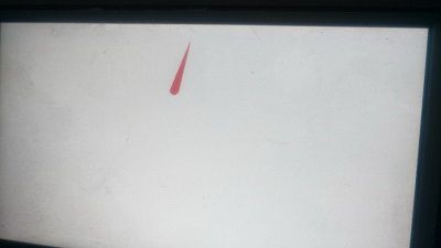

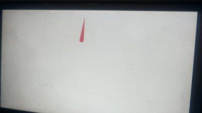

I still don't know why the pointer shrinks width wise after moving 28 times *****
I've shrunk the program down to the bare limits (I think) and I have kept it to one pointer rather than the compass double pointer I started off using as this fits perfectly with the wind vane direction picture I have ready to use*
I'm "very" close to what I need, I just need to know
1: Why it crashes on reaching 314 steps (movements)
2: Why the pointer shrinks after 28 steps
This is obviously extremely simple for most of you but because of my memory problems due to brain surgery it's extremely hard for me to comprehend.

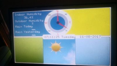

Gauge test on YouTube
Just uploaded a test of the gauge, I like how it works and looks, I'd be grateful if someone could take a look and tell me if it looks ok.
One problem I noticed is the time doesn't update while the test is running, thats because it's the only thing the MM is doing at that moment.
In real life it will only update with a wind direction change

Posted: 09:26pm 15 Aug 2017
@matherp @disco4now or anyone really
I found one "slight" problem
The needle on the gauge works perfectly, however while running the test overnight where I do a simple loop test ie the needle goes through all 360° and then runs again doing the exact thing
I end up with 2 needles
The original stuck on the North position 360° and the "new" needle doing what it's meant to do - moving 1 step at a time till it reaches north again
Anyone got any ideas why this is happening? or even better telling me how to clear the original needle before it starts drawing the new needle
I "think" it's to do with the "blit read" but not sure
I tried moving this into the loop where the needle gets drawn but it doesn't work there. (it says "buffer in use")
I'd like to solve this as it will probably cause a problem with the direction gauge when I finish the weather display properly
example picture
Edited by lew247 2017-08-17
disco4now
Joined: 18/12/2014
Posts: 1151
Posted: 01:56am 16 Aug 2017
Hi Lewis,
The initial
getlimits(x, y, w, h)
blit read #1, x, y, w, h
lines should only be run once I think. You might have to show how your are repeatedly call the code. The method below seems to work OK for me.
do
' Main program
for b = 1 to 360 'so I can see the pointer move one complete revolution
pause 10 'delay of 100mS so I can see the pointer steps
heading = heading+1 'increment the heading 1 degree clockwise
drawpointer(heading) 'draw the pointer
'print b 'so I can see how many times the pointer moves before it crashes
next b
loop
end
Also a modified drawpointer. i is used as an index. You are getting away with not setting it as you only have one triangle so the default value of 0 is working, but really should be set explicitly based on iterating through the number of triangles, I have added the for i=0 to nt-1 loops where required.
I have also added a loop using the getscanline() function in an attempt to reduce flicker on the screen
Sub drawpointer(angle as float, offset as integer)
local integer last_x, last_y, last_w, last_h, i
  for i=0 to nt-1
'rotate the pointer into the drawing array for each triangle
rotatetriangle(i,pcolour,angle,X_point+X_left,Y_point+Y_top,ptr(0),ptr(1),ptr(2),ptr(3),ptr(4),ptr(5))
NEXT i
last_x=x: last_y=y: last_w=w: last_h=h
blit WRITE #1, last_x, last_y, last_w, last_h 'update old rectangle with saved data
blit close #1 'free buffer
blit read #1, x, y, w, h 'save the new rectangle to memory
local integer k
do
k=getscanline()
loop while (k>200 AND k<350)
for i=0 to nt-1
'write new triangle for each triangle
triangle xx0(i), yy0(i)+offset, xx1(i), yy1(i)+offset, xx2(i), yy2(i)+offset, tcol(i),tcol(i)
NEXT i
drawpivot(offset)
End Sub
