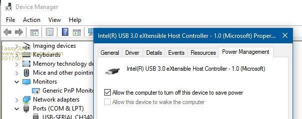

Make sure that the USB controller is not set to power saving mode.
Under Device manager, check the properties of all the USB controllers.
If you have something like this:
remove the tick.
This is for W10 but W8 is much the same.
I ended up with network attached storage to save that sort of problems. (There are other problems instead but a change is as good as a holiday)

Thanks, will check that - had not thought of that, but one would imagine that if the system was talking to the drive, windoze should not try to power it off.....
...but then, windoze does so some strange things....
