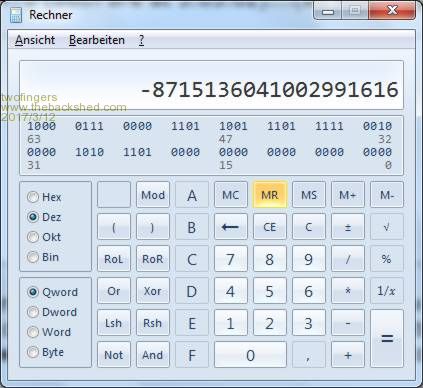

  Geoffg said   Yes, this is something I have bee thinking about. Languages like C do no checking but a more programmer friendly language like BASIC should raise a warning.
The problem is, as you noted, the overhead in checking each operation. Given the very large range of integers it is not often that you get overflows in real life programs. So, do you want to slow down all programs to check for a rare event?
Maybe this could be done with a OPTION CHECKINTEGEROVERFLOW or something like that. Then it's up to the user to accept the deceleration.
BTW. Windows 7 behaves in the same way :
4865804016353280000 x 2 gives:

and after testing in detail, I agree totally and personally think it is a thing of beauty as it is - shifting,xor, multiplication,\,MOD all work exactly the way digital logic in the early 8-bit micros do (albeit with 64 bits), so I support the view that it shouldn't crash out or be altered.
There are many routines that would find existing behaviour useful. I am working on a hash table algorithm that I suspect should actually work faster because of this feature (de-facto mod 2^64 function is performed during all operations - if we think of it as 64-bit unsigned number)
