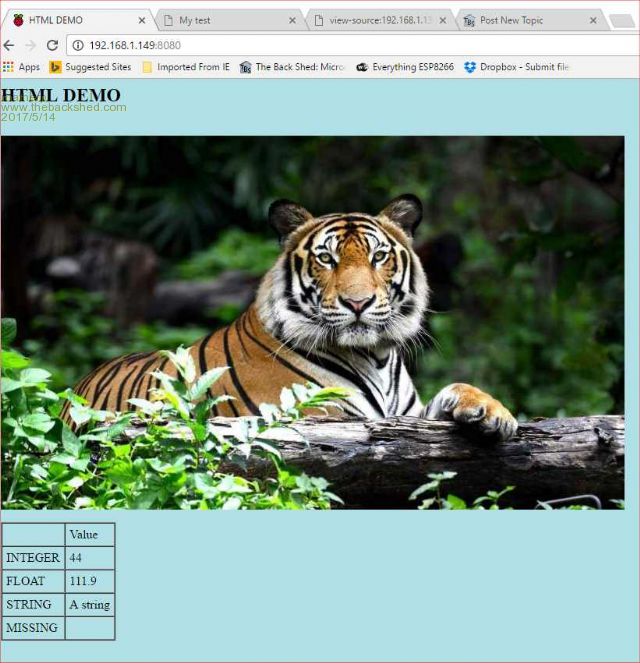

Please find attached version 5.3.a29 of the Pi-cromite software
2017-05-14_113836_mmbasic.zip
This now includes the full capability to program fairly sophisticated webserver applications with stylesheets, embedded pictures, and favicons entirely in MMBasic
HTML pages can be written and stored as files. These can have MMBasic variable names included within the file in {} brackets and then these will be filled in from the current values in the MMBasic program when the page is requested.
To explain this an example is probably best. Here is the simple HTML file used to create the image above.

In it there are four MMBasic variables referenced: tcurrent, tmax(2), tmin, and fred
In my test program (full version below) these are defined as follows:
Option explicit
Option default none
Dim integer tcurrent=44
Dim float tmax(3)=(19.6, 22.4, 111.9,88.6)
Dim string tmin="A string"
Note that "fred" is not defined and I am using option explicit
to display the page from MMBasic we simply use
TRANSMIT PAGE "filename"

You should be able to look at the demo on a Pi Zero W at this address. Let me know if it worksEdited by matherp 2017-05-15
Posts: 3881
Posted: 11:16am 14 May 2017
  matherp said  Let me know if it works
That page works for me. When I "view source", this is what I see.

If Abs(tnew-tcurrent)<10 Then tcurrent=tnew
updateheater
If tcurrent>tmax Then tmax=tcurrent
If tcurrent<tmin Then tmin=tcurrent
Sub myint
Local p%=0, t%=0
Local g$
Do While Not Eof(2)
LongString append a%(),Input$(10,2)
p%=LInStr(a%(),"GET",1)
t%=LInStr(a%(),"HTTP",1)
If p%<>0 And t%<>0 Then 'full request received
s$=LGetStr$(a%(),p%,t%-p%+4)
LongString trim a%(),t%+4
pg$= parserequest$(s$,i%)
If i% Then
If arg$(0,0)="Security" And arg$(1,0)=security$ Then 'valid update
If arg$(0,1)="R" Or arg$(0,2)="R" Then
cp(checked)=""
If arg$(0,1)="R" Then checked=Asc(arg$(1,1))-Asc("A")
If arg$(0,2)="R" Then checked=Asc(arg$(1,2))-Asc("A")
cp(checked)=check$
updateheater
EndIf
If arg$(0,1)="Check" Or arg$(0,2)="Check" Then
tmin=tcurrent
tmax=tcurrent
EndIf
EndIf
EndIf
If pg$="index.html" Then
Transmit page "index.html"
Else
Transmit code 404
EndIf
EndIf
End Sub
'Function to parse an HTML GET request'
' Assumes that the request starts with "GET /"
' and ends with "HTTP"
Function parserequest$(req$, paramcount As integer)
Local a$,b$
Local integer inpos,startparam,processargs
For inpos=0 To maxargs-1
arg$(0,inpos)=""
arg$(1,inpos)=""
Next inpos
paramcount=0
a$=Mid$(req$,6,Len(req$)-10)
inpos=Instr(a$,"?")
If inpos<>0 Then 'parameters found
processargs=1
parserequest$=Left$(a$,inpos-1)
a$=Mid$(a$,inpos+1)
arg$(0,paramcount)=""
arg$(1,paramcount)=""
inpos=Instr(a$,"=")
startparam=1
arg$(0,paramcount)=Mid$(a$,startparam,inpos-startparam)
startparam=inpos+1
inpos=Instr(a$,"&")
If inpos<>0 Then
arg$(1,paramcount)=Mid$(a$,startparam,inpos-startparam)
a$=Mid$(a$,inpos+1)
paramcount=paramcount+1
Else
arg$(1,paramcount)=Mid$(a$,startparam)
processargs=0
EndIf
Loop While processargs
Else
parserequest$=a$
EndIf
If a$="" Then
parserequest$="index"
EndIf
If Instr(parserequest$,".html")=0 And Instr(parserequest$,".HTML")=0 Then
parserequest$=parserequest$+".html"
End Function
Sub updateheater
Local float hcalc
If checked=11 Then
Pin(relaypin)=1
heating="On"
hcol=hon$
EndIf
If checked=0 Then
Pin(relaypin)=0
heating="Off"
hcol=hoff$
EndIf
If checked>=1 And checked<=10 Then
hcalc=checked+starttemp-1 'setpoint temperature
If tcurrent>hcalc Then 'turn heating off
Pin(relaypin)=0
heating="Off"
hcol=hoff$
EndIf
If tcurrent<hcalc Then 'turn heating on
Pin(relaypin)=1
heating="On"
hcol=hon$
EndIf
EndIf
End Sub
and the HTML including the variable substitution strings
<html>
<head>
<title>Remote Thermostat</title>
</head>
<body>
<form name='f1' method='get' action='index'>
<h2 align='left'>Remote Thermostat V4.0</h2>
Update Code: <input type='text' name='Security' size='6' value='000000'>
<br>
<p>
<TABLE BORDER='1' CELLSPACING='0' CELLPADDING='5'>
<TR>
<TD>Heating</TD>
<TD BGCOLOR='{HCOL}'>{heating}</TD>
</TR>
</TABLE>
</p>
<p>
<TR>
<TD></TD>
<TD>Temperature</TD>
</TR>
<TR>
<TD>Current</TD>
<TD>{TCURRENT}°C</TD>
</TR>
<TR>
<TD>Max</TD>
<TD>{TMAX}°C</TD>
</TR>
<TR>
<TD>Min</TD>
<TD>{TMIN}°C</TD>
</TR>
</TABLE>
</p>
<input name='Check' type='checkbox' value='Reset' onClick='this.form.submit()'>
Reset Max/Min<p>
<TR>
<TD>Thermostat</TD>
<TD><input name='R' type='radio' {CP(0)} value='A' onClick='this.form.submit()'> Off<br></TD>
<TD><input name='R' type='radio' {CP(1)} value='B' onClick='this.form.submit()'> {SP(1)}°C<br></TD>
<TD><input name='R' type='radio' {CP(2)} value='C' onClick='this.form.submit()'> {SP(2)}°C<br></TD>
<TD><input name='R' type='radio' {CP(3)} value='D' onClick='this.form.submit()'> {SP(3)}°C<br></TD>
<TD><input name='R' type='radio' {CP(4)} value='E' onClick='this.form.submit()'> {SP(4)}°C<br></TD>
<TD><input name='R' type='radio' {CP(5)} value='F' onClick='this.form.submit()'> {SP(5)}°C<br></TD>
<TD><input name='R' type='radio' {CP(6)} value='G' onClick='this.form.submit()'> {SP(6)}°C<br></TD>
<TD><input name='R' type='radio' {CP(7)} value='H' onClick='this.form.submit()'> {SP(7)}°C<br></TD>
<TD><input name='R' type='radio' {CP(8)} value='I' onClick='this.form.submit()'> {SP(8)}°C<br></TD>
<TD><input name='R' type='radio' {CP(9)} value='J' onClick='this.form.submit()'> {SP(9)}°C<br></TD>
<TD><input name='R' type='radio' {CP(10)} value='K' onClick='this.form.submit()'> {SP(10)}°C<br></TD>
<TD><input name='R' type='radio' {CP(11)} value='L' onClick='this.form.submit()'> On<br></TD>
</TR>
</TABLE>
</p>
</form>
</body>
</html>
