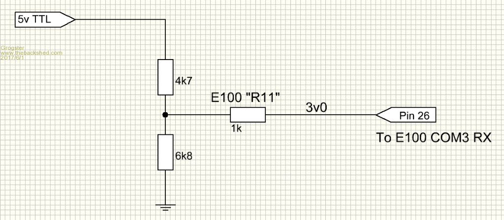

Hello folks.
I have a 5v TTL RF receiver connected to COM3 on the E100(via CLICK 1 socket), which is a 3v3 input. The E100 has a 1k series resistor on this line(R11), and all is working fine with the 5v input, but I figured it might be safer to put a potential-divider in front of that input, to keep the voltage within the 3v3 specs, so I built this:
...but I then get no response from the system.
The voltage on COM3 RX is 3v0, which is spot-on within spec, so I would have expected it to work? (electrical specs of the manual say a logic-high is >=2v5)
I have an E64 where I do this, but it does NOT have the 1k "R11"(just the potential-divider - in that case 2k2/4k7), and this idea works just fine on that one, so it must be something to do with the 1k series resistor, but I can't see HOW this is stopping it. For now, I have gone back to the 5v input on COM3 via CLICK 1 socket.
Can anyone offer any explanation, as I am scratching my head at the moment....

Grogs
does the voltage on pin 26 hold up when you define it as a digital input? If not then you may have to lower your 4k7 and 6k8 resistors and / or remove the 1k resistor. I don't know what load the PIC has on the line but it may be dragging the signal down more than 0.5 volts.
You can afford to lower your resistors since you are dragging about 40 microamps through the divider.
Bob
Posts: 2981
Posted: 06:59pm 31 May 2017
Grogs,
I think the divider alone might work (scrub the 1k) but you might be better off with just the 1k direct from the 5V RF output to Pin26.
If you were really concerned clamp pin26 with a diode that has the ANODE at pin 26 and the CATHODE at Vcc using a 1N5817 (or IN5819) SCHOTTKY diode.

Measure the 'low' voltage on the pin.
I expect that the internal pullup is preventing it going low enough.
1k series without the potential divider is usually reliable.

Do you actually have the internal pull-up enabled?
If yes, try it without. (Unless you need it.)
Posts: 10043
Posted: 10:54pm 31 May 2017
No, I don't. It is the COM3 input pin, so unless this command pulls it up in the background.....
The RXD output from the RF module is idle-high via 10k anyway.
Goes perfectly without the divider and just using the built-in 1k series resistor, but it just makes me a little anxious applying 5v to what is technically a 3v3 input.
Posts: 3368
Posted: 11:31pm 31 May 2017
There is an internal weak pullup applied on COM3 when it is opened and that is probably the cause. You can disable this by installing the ChangePin CSub (included in the Micromite zip) and using it like this: ChangePin 26, 15
You are right to be anxious about using only the 1K resistor. It was assumed that protection diodes on the input (most micros have them) would clamp the voltage to Vdd but with further investigation I have found that on the PIC32 there are no protective diodes and no clamping. The best way to go would be to use an external general purpose diode (eg, 1N4148) from pin 26 to Vdd to clamp the input.
An alternative would be to use a voltage divider as you did and turn off the pullup.
Geoff

UPDATE:
The CSub worked!
I did change the command to:
ChangePin 26,13 'Disable internal pullup on COM3 RX - See ChangePin CSub PDF.
But that done, it works perfectly fine with the potential divider AND the series 1K resistor on the E100 board.
Thanks for the prod in the direction of that CSub, Geoff.

That begs the question:
Since the weak pull up is 60K and the RF Module is outputting 0V
the PIN(26) should see about 0.176V.
Clearly this would still look like a low.
Something else besides the 60K pull up is not right.
The 60K shouldn't have any effect at all.
Since the 60K does have an effect something is on the harry edge.
I bet the RF module is not pulling its output to 0V.
