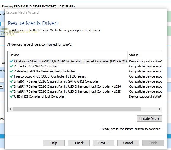

Paul,
one of my PCs is quite similar to your HW, just slightly newer i5
It runs W10Pro
Macrium Rescue is somewhat driver/chipset dependent - these are my drivers:
I generated a rescue ISO and uploaded it to Dropbox
Macrium Rescue ISO Download
I booted a CD generated with the same setups
It takes about 10 Min to come up - but seems to work
Good Luck !

I got on the phone and talked to Steven at Macrium. We actually understood each other, he speaking his midlands Manchester dialect, me speaking Brooklynese!
He knows about the VSS problems in Reflect Free caused by microsoft's arbitrary change. He has a new version of Macrium Free in test and it will be out in about a month. However, he also has a $75 workstation version available available now.
He says that the current workstation version will be able to restore the destop's system from any of my older image files.
My most recent Macrium image is from 4/8/2017. I have not installed any new software since then and I have made frequent file copies of everything with robocopy so I will get the newer Macrium Reflect Workstation version and see if it works.
I'll post the results after I've tried it.
