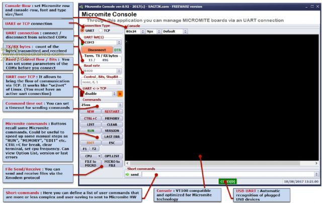

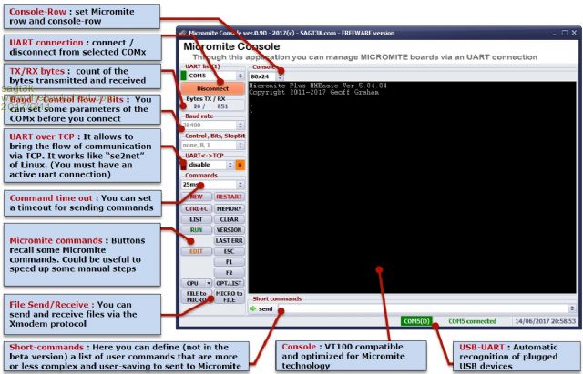

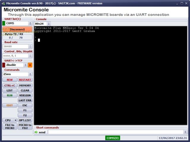

Hi to Everybody
I'm developing a series of applications with a new platform and wanted to share this first application with you, "Micromite Cons", which is totally FREE, portable and optimized for all Windows O.S. XP/7/10 32&64bit.
Is a simple console that allows you to connect to any COMx port that is connected to a board with Micromite board.
The features:
- Console is optimized for micromite tech
- different shortcuts to optimize some frequent steps
- UART over TCP capability
- Xmodem protocol for data transfer Micromite>PC, PC>Micromite
- Ability to modify the rows in real time

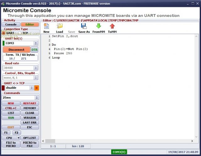

Posted: 10:22am 19 Aug 2017

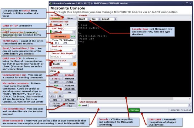

Hi to Everybody
A small summary of "Micromite Console Beta v.0.922", here some features:
+ VT100 terminal on UART or TCP connection
+ Autodetect USB/UART
+ TCP server, serial on TCP service with :port (as SER2NET)
+ Send/Receive data with Xmodem protocol
+ Drag & Drop file .bas from Win/Explorer to Console (direct file transfer)
+ Start implementing of an editor with several features (from ver. 0.922)
+ Drag & Drop file .bas from Win/Explorer to Editor (load file on Editor)
+ Send/Receive data with Xmodem protocol to/from Editor
- Saving settings (To be implemented)
- Editor, search, and replacement functionality (To be implemented)
here you can find link download
Thanks for your suggestions.

KeepIS
Joined: 13/10/2014
Posts: 2265
Posted: 07:12pm 19 Aug 2017
Just tried your program, very nice. I like the speed when editing a big program. However some of the coloured text is very dark in the Console window in edit mode.
Over all the text is dimmed in that window, I will play around a lot more as soon as I get time, really like it so far. I think this will be really great as it progresses.
BTW transferred a 1,700 line program from the E100+ memory to the editor in a second or so, very fast.
Mike.
EDIT: All white text in the console window in edit mode is black - not visible.

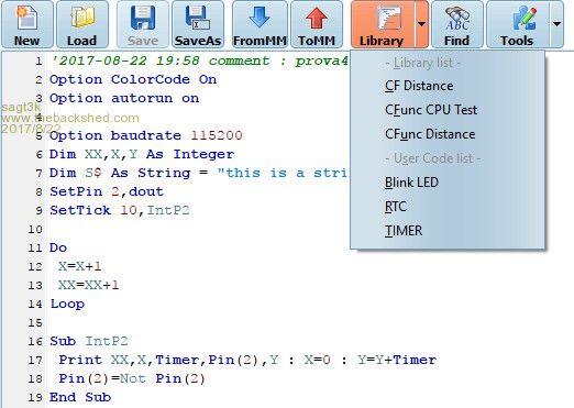

Hi to Everybody
New features have been implemented in the editor on ver.0.924:
+ When start application 2 directory are created \Library and \UserCode. Here you can copy .bas files to make them available to the popup menu "Library". When selected the file will be inserted in text editor.
+ Text proposal when digit a part of text or press CTRL+SPACE
+ Standard popupmenu on press right mouse button
+ Implemented "Tool" button. A few features implemented including a comment entry and the "goto line".
- It still remains to complete all the MMbasic instructions with CTRL+SPACE
- It still remains to complete save of settings
Here the link to
download v.0.924

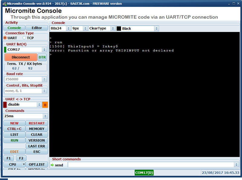

Posted: 08:54pm 22 Aug 2017
Pressing the RUN button brings up this error.
Type RUN and everything works fine. What command are you sending apart from "RUN" when the run button is pressed?
Edited by KeepIS 2017-08-24
NANO:Inverter V 8.4ksLinux AvrDude GUI script V4.1
KeepIS
Joined: 13/10/2014
Posts: 2265
Posted: 09:14pm 22 Aug 2017
So this is interesting, I have a CTRL-C Handler, if I remove the global declaration for the string ThisInput$ and place it into the Handler as a LOCAL variable, your button works.
If I just comment out the Global declaration in my code, then of course, typing RUN brings up the the same error. BTW the Ctrl-C Handler reinstalls the original handler on exit.

Posted: 09:31pm 22 Aug 2017
Yes Mike
You are right. I send ctrt+c for all buttons command. This to ensure that mmbasic-hw is at prompt. After I send the command.
KeepIS
Joined: 13/10/2014
Posts: 2265
Posted: 10:39pm 22 Aug 2017
Well, looks like others running a CTRL-C handler will need to test this, but size of program could play a part in RUN timing? like I said, it's not a problem as I just type RUN. I'm guessing it's the timing between the CTRL-C and RUN command sequence.
