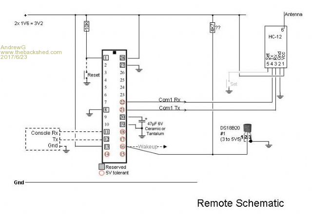

Hi,
I am trying to power a remote temperature sensor with two AA cells but appear to be only getting less than two day's life out of the batteries.
1) Is my circuit OK?
2) Would 3x AAAs be better?
The batteries are powering a MM (28 pin), an HC-12 and a DS18B20.
The remote code is below. It sends a simple NMEA sentence (with checksum) twice, then sleeps for 59 seconds. If the temperature is unchanged it goes straight back to sleep, otherwise it sends the new temperature (twice) then goes to sleep.
I can:
a) extend the sleep time (10 minutes is better but I wanted to see more readings whilst developing the code)
b) reduce the CPU speed
c) send the sentence only once and discard any erroneous transmission receipts
d) turn the power down on the HC-12 (a marginal(?) improvement at the risk of reducing range within the house)
3) which of these are likely to give most bang for the buck?
4) Is there anything else I can try and any improvements to the code??
Cheers,
Andrew

Have you set the HC-12 into low power mode.
I haven't done any tests but the datasheet has idle current of 16mA in the default mode compared with 80uA in FU2 mode
Using 3 AA cells will put the voltage higher than the micromite can handle.
2 cells has the voltage good for the micromite but marginal for the HC-12 as the voltage drops off.
Posts: 10043
Posted: 09:26pm 22 Jun 2017
Completely agree with Jim here. You need to connect the HC-12's 'SET' line to one of the MM I/O lines and use that to put the module to sleep. This is a LITTLE more tricky then most other modules that just use an EN(able) line to control the module.
In the HC-12, you have to:
1) Put the module into SETUP mode by pulling the 'SET' line low
2) Issue the command AT+SLEEP via the serial port
3) Return the 'SET' line high again
Current consumption of a sleeping HC-12 is about 22uA so says the datasheet.
To wake up a sleeping module, you have to pulse the 'SET' line low again(50mS should do it), then return the line high again and WAIT 200mS for the module to reset itself.
I plan to do some testing on this concept shortly, so I will be able to confirm this soon, as I have not actually ever slept an HC-12 module, but reading the datasheet, the above would appear to be the sequence.
Edited by Grogster 2017-06-24

Thanks Jim and Grogster,
I'll certainly give it a go.
Do you have any experience of how long a MM should go with 2x AAs without the extra drain of the HC-12 (and DS1820)?
I haven't cracked changing the settings of the HC-12 yet (it worked with the default values - once I sorted out the Tx/Rx swap). I actually have two transmitting temperatures to the one receiver. I have yet to incorporate it into useful software but I will.
Thanks again, Andrew

Page 15 of the Micromite User Manual gives some hints on reducing the sleep current of the Micromite. They might help.
Geoff

Thanks Geoff and Grogs. I have plenty of options to try out . . .
(I assume my circuit is OK except that I should connect all unused pins on the MM to Ground?)
Cheers,
Andrew

I have been distracted over the last two months but I am still trying to minimise consumption on my remote temperature-sensing MM. I believe I have included all of your suggestions in the code below (if not pl. let me know) but I still have a sleep current of 0.5mA - much better than before but is it the best I can achieve?.
Is the DS18B20 causing this?
The circuit is the same as above except that pin 5 of the HC-12 now goes to pin 14 of the MM.
Thanks again,
Andrew

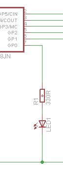

play around with putting the CPU20 command right before measuring the temperture and then going back to CPU 5 right after. You might find you need a tiny delay after a CPU change.
Take off all LEDs if there are any (HC12 etc. why do manufacturers make them so bright? even hi efficiency, drive them thru a higher resistor. I always end up touching them with a marker to tone them down.)
Also, it is extreme, but think of powering the external devices via FETs using some of your unused pins to control the power to the devices (you'll have to take the 1820 out of parasitic VCC mode). If you go to 3 AAs this will overcome the voltage drop in the FET but you'll need to do something about the power to the MX170 - perhaps split the supply rails by tapping between cells 2 & 3. It is the only way to make sure something is really off. You'll need to play and might need a delay just before use and beware some things don't like signals on their inputs with no VCC applied - it rarely breaks them but moving into an indeterminant state internally can make power-drain worse. BS170, 2N7000 both can do a couple of hundred mA through them (HC-12 can get to 160 in hi-power mode!) and have gate thresholds that would suit your application. Bound to be others so check through your junk box. If you want to avoid using pull-down resistors on their gates, make sure you set the control pins LO first thing in your prog but even then I would recommend them.Edited by CaptainBoing 2017-08-13

Cap'n, thanks. No LEDs that I can see but would it have been OK to just take them out?
I'll make the speed changes and I like the idea of a third AA battery as the HC-12 can go to 5V. I could put it either side of the 4K7 resistor and see whether it or the other two die first (although the two could keep the one up so it is not too precise).

  Andrew_G said   No LEDs that I can see but would it have been OK to just take them out?
It should be, most indicators run them as below - it is very bad practice to run a signal through them - unless you are specifically trying to exploit the properties of the LED.
Consider this: without the LED, no current flows to ground so reduced power consumption

  Andrew_G said   I have been distracted over the last two months but I am still trying to minimise consumption on my remote temperature-sensing MM. I believe I have included all of your suggestions in the code below (if not pl. let me know) but I still have a sleep current of 0.5mA - much better than before but is it the best I can achieve?.
Andrew,
Time to measure the current through each the several branches of your simple circuit to get to the bottom of where that .5 mA is going to! I would start by measuring the HC-12 and the MX170.
According to the relevant data sheet information, you're still high by a few hundred microamps. (8 bit processors will go several orders magnitude lower than the MX170 in sleep current.)
When using sleep mode, in general lowering the clock speed of the uP does not give any advantage in long term average current use, since the uP when awake takes longer to accomplish its tasks while in run mode. The sleep mode current is fixed -- not affected by the run speed.
Incidentally, the minimum voltage for the DS18B20 in parasitic mode is 3 volts, whereas in direct power mode it's 2 volts. I'd recommend the direct power mode connection anyway.
HankEdited by HankR 2017-08-13

Cap'n and Hank, thanks. You make some good points. I was wondering if consumption when asleep was affected by its awake speed. I now have some more things to try (it may be a day or so before I can report back). Andrew
