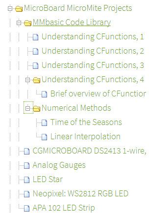

Phil23
Joined: 27/03/2016
Posts: 1667
Posted: 01:08pm 05 Jul 2017
  Geoffg said   No, because it is so easy to implement in BASIC I will not include it in MMBasic. The language does not need to be cluttered with functions that can be encapsulated in a simple subroutine.
Geoff
The only catch with these Simple Subroutines is either knowing they exist, and being able to find them.
Maybe this could be addressed by Glenn creating a Sticky Post that can contain those code snippets.
That would be a great asset to new comers visiting the site.
There is the MMbasic Library Pinned thread, but it's well out of date.
If Glenn's able to do this, with either 1 or 2 threads, I'm sure others would volunteer to administer that thread & move of delete posts as appropriate.
Phil.
CircuitGizmos
Joined: 08/09/2011
Posts: 1427
Posted: 01:24pm 05 Jul 2017
I've offered before and I'll offer again that the CG site can be used for library routines.
The site is behind on updating. I would need help from some "librarians" to capture and annotate various library functions.
CaptainBoing
Joined: 07/09/2016
Posts: 2171
Posted: 06:35pm 05 Jul 2017
<snip>
This was discussed in a post a while back.
There are two options detailed there. One I believe better than the other (for various reasons )
As Geoff said at the time when I set up the wiki, the problem is keeping the impetus - people forget to publish what they do. Several regular members of TBS have joined the wiki (membership makes it possible to contribute and critique articles - reading is open to all) there is lots of stuff that gets posted here that should be kept for posterity but isn't and forums are not meant to be code libraries.
* Dedicated to doing one task well.
* No single "keeper" - Everyone can add articles at any time.
* Everyone can police/correct/modify articles at any time.
* Rich articles with pix & graphics to support the thinking behind.
* Focused discussion.
* Article history with roll-back.
* Searchable within the wiki.
* Searchable on the web.
At the time I set up the wiki, neither Geoff nor Hugh (the original keepers of the library) had the time or resources to maintain it and having a single person look after it with snippets "sent" in, as it was is frankly archaic - we can all contribute AND share the load - we all should.
This wiki is a free, non-commercial, ad-free, up-to-date as we make it (community driven) method of making sure great stuff stays with the community and stays visible.
hEdited by CaptainBoing 2017-07-07
