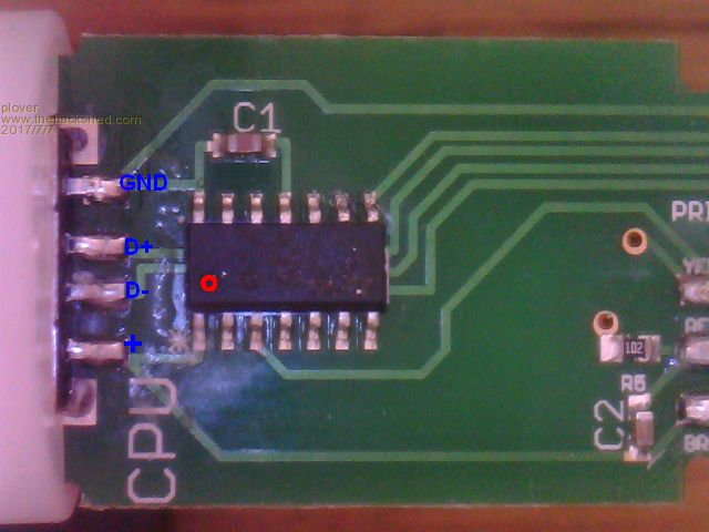

Slip of concentration cost me a small micro in a gas analyser instrument. Because of poor contacts in USB connector I decided to hard wire a usb cable in place. From old times I always remember that many 14 pin ICs have positive on pin 14, well on this chip this is ground and and pin 1 is positive.
I reversed polarity and good bye micro, RIP, and I am sorry.

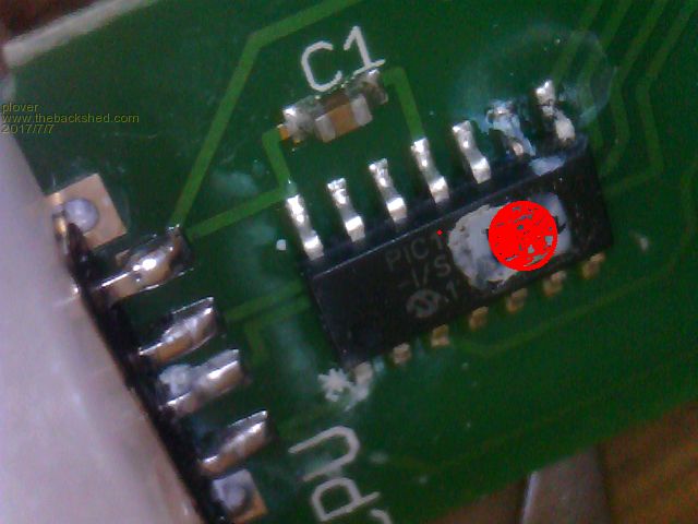

RIP indeed! I also destroyed an early MicroBridge (PIC1454) for the same reason! That will teach me to look at the pinout first!
No need for a nozzle . . .
For removing the chip I would use a sharp (modelling) knife and cut the pins at the chip body. This will result in the black plastic part falling away, and all the pins sticking up from each track.
Then simply use an iron to remove the pins (not much heat need here), and then use solder wick and liquid flux over each pad to remove any excess solder. This will leave a nice set of clean pads ready to resolver you replacement chip.
I have used this technique successfully whenever I need to replace a SMD chip.
Hope this helps you out . . .

Here is a pic with USB lines annotated.
Should just add that I am reasonably sure I have identified the chip as the 1455 but no guarantee as it is very hard to read after removing a dab of paint hiding details.

Thanks for posting, nice to know I am not the first, my pride have taken a real beating. Some months ago I had identified correctly but last night when I had to do the change, plug just not working properly. The little man on my shoulder was baging away on my head but I ignored that I should have gone to bed and rechecked in the morning. Well look forward and try and look at the situation as a challenge.
As I understand you are cutting vertically? Not worried about horizontal force at the top of the "stumps" lifting the track? Enough glu force on the small tracks to cause slight bend? (It is FR4 board I think)
So far I hgave not tried proper liquid flux and solder wick has been rather a disaster for me over the years, Seems both proper and fake wick has been disapointing. Perhaps getting some liquid flux and dipping the solder wick might help.

WW's method of cutting the IC's pins with a sharp knife works well but don't let the tip of the knife touch the PCB. The first time I used that technique I also cut the copper tracks under the IC.
Geoff
Posts: 2991
Posted: 03:54am 07 Jul 2017
With a very sharp knife, I cut one pin at a time cutting at 45 degrees along where the pins meet the body. This way, only the 'point' of the knife may come into contact with the PCB; but I do try to cut with the knife 'in the air' (i.e. above the PCB).
And by using a very sharp knife, then minimal 'pressure' is required to cut the pins resulting in the tracks (even very fine ones) remaining in one piece, and not lifting from the PCB itself.
I would advise against using a 'slicing' action to cut the pins as this will probably result in cut tracks too.

You could always use my favourite - ChipQuik low-melting-point solder for rework.
This is not exactly cheap stuff, but you only use a tiny amount each time.
This allows you to very cleanly and easily remove a chip, and at low temperature - I usually use about 300'C. Running this carefully(so as not to use too much!) around all the pins, and then keeping them hot like matherp was saying he does, and the chip is very easy to remove, as this stuff stays liquid MUCH longer then standard solder does.
An option for you to consider anyway. Many people are put off this stuff cos it is expensive, but it works.
