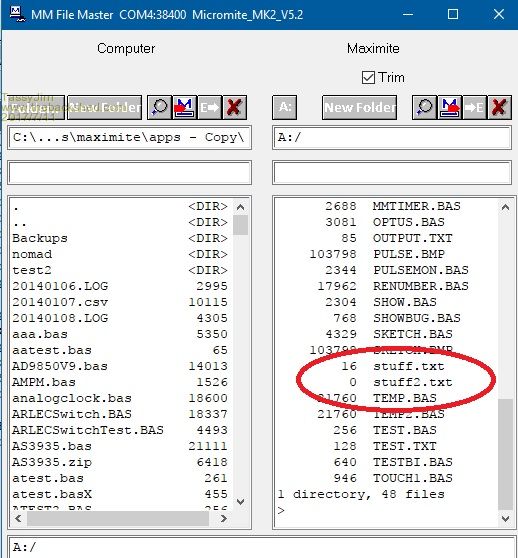

For debugging purposes running under both DOS and on a PIC chip will MMBasic close and flush a debug file as it crashes?
open "stuff.txt" for output as #1
print #1, "line 1"
' something in here screws up and it crashes
print #1, "line 2"
close #1
It's obvious that "line 2" will never be printed, but will the first print line "line 1" appear and will the file be closed?
If it crashes back to a the MMBasic interperter command window will I be able to enter "CLOSE #1" in immediate mode to close the file?
Will the file then be readable?
Paul in NYEdited by Paul_L 2017-07-12

Only one way to see;
  Quote   OPEN "stuff2.txt" FOR OUTPUT AS #1
PRINT #1, "line 1"
PAUSE 200
x = y/
0
PRINT #1, "line 2"
CLOSE #1
The data probably gets written to file progressively but without closing, not good.
For the best security, close then reopen frequently.
Even reopening an existing file to append might be risky.
Posts: 6606
Posted: 09:26pm 10 Jul 2017
More playing
I added a bit more code
  Quote   OPEN "stuff2.txt" FOR APPEND AS #1
PRINT #1, "line 1"
PAUSE 200
' x = y/0
PRINT #1, "line 2"
CLOSE #1
PAUSE 1000
PRINT #1, "line 1"
PAUSE 200
x = y/
0
PRINT #1, "line 2"
CLOSE #1
And ran it.
Not only was the two lines from this run there but also the first line from the previous program.
  Quote  line 1
line 1
line 2
I assume that there is a lonely "line 1" sitting there in nowhere land from the error in the second run through the printing.
There might be a timed flush at play somewhere.
And if you go back and enter CLOSE #1 at the command prompt, the extra bytes get written.
This is even after opening the file with XMODEM in between crashing and closing.
All my testing was with a MMX running V5.4Edited by TassyJim 2017-07-12

The file system code used by the Micromite is FatFs.
This has a 512 byte buffer per open file. Writes take place to the buffer and are flushed to disk when the buffer is full or when the file is closed.
To be certain each write takes place close the file after each write and re-open it with append access.
There is a FatFs command to force a buffer flush and Geoff and I discussed including a Basic command to execute it but, from what I can remember, we decided using close/re-open was good enough to avoid using another valuable command slot.

  matherp said  FatFs has a 512 byte buffer per open file. Writes take place to the buffer and are flushed to disk when the buffer is full or when the file is closed.
So essentially,
If the buffer contains the less than 512 bytes, not yet written,
and everything crashes, the Directory entry & FAT entries will still be intact as per the last flush to disk.
Therefore the file should be intact & readable, just missing the last < 512 bytes waiting to be written from the buffer.
Is that a correct interpretation?
