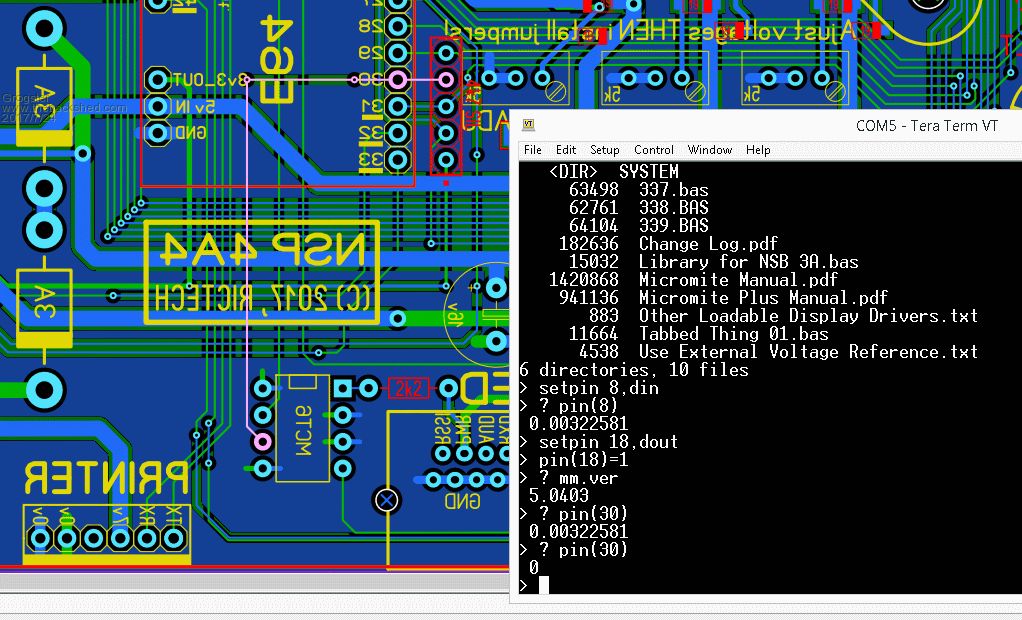

This has me a bit lost.
MM+ E64, external 4k7 SIL pull-up array, connected to an MCT6 dual opto-coupler.
When the opto is active, and it's transistor is pulled down, the input is zero - exactly as it should be.
When you remove the DC from the MCT6 LED, the MM+ I/O pin goes high, but the MM+ only reads this as 0.00322581
This number is always the same, and across any other pins I setup as inputs.
Has anyone seen this, cos it has me baffled - it should be working, but isn't.
The voltages are correct on the pins, but MMBASIC responds with this really odd result.

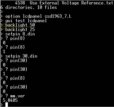

UPDATE: Perhaps we had a corrupted firmware somehow? I flashed the latest into the E64, and everything is as it should be - no odd results for the digital inputs.

3.3/1023=0.00322581
rob :-)

Posts: 2552
Posted: 03:20pm 24 Jul 2017
somehow it was taking the logic '1' and deciding it needed to interpret it as an analog value (that ranges between 0 and 1023). i guess there is an internal table within mmbasic (in RAM) that tells how to interpret each pin - as analog, digital, counter input, etc., and that this was corrupted. i presume resetting and/or cycling power did not fix the issue; perhaps the corruption was in the code that initialized this table upon power up?
rob :-)

No, resetting the power DID NOT clear the problem. Reflashing did.
This unit did have the ALPHA for the PLAY WAV on it at one point in time(the board was labelled as such), so it is indeed possible that the alpha for this was perhaps causing some issue - who knows - that's what I will put it down to at this stage, as an alpha can be notoriously unstable.
No problems since reflashing to the latest stable anyway. Hopefully it will stay that way now.

Posted: 06:59am 25 Jul 2017
I may be wrong, but it seems like your silkscreen says... Ajust voltages and THEN install jumpers. You might want to adjust this before you go to pcb...
Ajust is a caustic blend that helps sustain a pH range that is ideal for controlling pathogens in the chiller. Ajust is used in conjunction with Peragonn or Protec, allowing their antimicrobial activity to be maintained for a longer period of time. It also has approval for usage in organic processing.Edited by viscomjim 2017-07-26
Posts: 10043
Posted: 09:18pm 25 Jul 2017
WELL SPOTTED!!!!
I only got five of these PCB's made, as they are as big as the 7" LCD they are paired up with, and that size board is expensive. Surprised(and annoyed!) that I miss-spelled that! Edited by Grogster 2017-07-27
