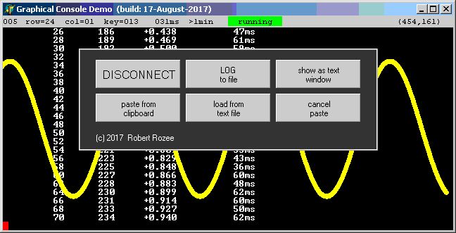

attached is a demo of a graphics terminal for the micromite i've been tinkering with for the past few weeks:
2017-08-17_123000_demo_17-aug.zip
this is essentially a VT220 terminal emulator with a glass graphics plane added over the front. the text and graphics are completely independent:
as this is just a demo, instructions are pretty scarce i'm afraid. upon running GFXterm.exe just right-click on the text area to bring up a panel of 6 control buttons - the top left one is 'CONNECT', which will get you started. the format of the connection string is:
PORTNAME:SPEED
so in my case i type in COM3:38400
two special key combinations are implemented:
alt-B sends a break to the serial port to reset an E-28 or similar
alt-C clears the graphics plane, you'll quickly find this useful!
there is a basic demo program included in the zip file that draws a sideways scrolling sinewave.
graphic commands are invoked with the print statement using the following format:
PRINT chr$(16) <command> param1, param2, ...
the available graphics commands are outlined in an included PDF. at the moment i've implemented the following:

The test program is running here on an old XP notepad and alt-B works when its running except that the 'break' only lasts about a second then it starts running again. Alt-C clears the graphics properly and stops.
The test program wouldn't load with the 'from file' box nor from the 'paste from clipboard' box. In both cases it gave errors on all the DO and LOOP statements. It loaded properly using MMEdit and then it ran from the GFX window (using RUN) OK.
I tried to draw a line using:
PRINT chr$(16) L 100,100,200,200
from the GFX prompt but just got normal MMBasic back a la:
0 100 100 200 200
I'm probably missing something here.

Posts: 2552
Posted: 04:49am 18 Aug 2017
paceman:
oops, my mistake, the command should be in quotes. so the correct syntax is:
PRINT chr$(16) "<command>" param1, param2, ...
if you're micromite isn't connected to the PC via a 1455 running peter's firmware then alt-B will have no effect. what alt-B does is send a "set break" command, then 100ms later sends a "clear break" command. only peter's 1455 firmware interprets this as a command to reset an attached micromite.
when pasting, were you loading into the editor, or using autosave? unfortunately pasting into the editor has various issues and is extremely hard to make work reliably, while i've always found autosave to be quite reliable.
how both types of pasting work is that each line of text is sent to the micromite, then GFXterm waits until there has been silence from the micromite for 60ms before sending the next line.
pasting into the editor could likely be made to work reliably if the mmbasic editor implemented software flow-control (XON and XOFF). it would not need to respond to XON/XOFF commands from the terminal, but just to send the commands when accepting input. the editor also seems to do a great deal of unnecessary screen redrawing whenever it sees a carriage return.

Posted: 03:49am 19 Aug 2017

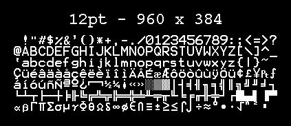

here's a new beta that allows for 3 possible font sizes: 9pt (default), 12p, and 14pt.
2017-08-19_134404_demo_20-aug.zip
the 'cancel paste' function has now been moved to an alt key. there are now SEVEN alt key combinations that do things:
alt-Z cancel a paste from clipboard or load from file that is in progress
alt-C clear graphics plane
alt-B send 'break' to the serial port
alt-1 select 9pt font size
alt-2 select 12pt font size
alt-3 select 14pt font size
alt-0 insert break line in command window (see below)
changing font size (alt-1/2/3) clears the text and graphics screens, and homes the cursor.
the bottom right button on the control panel (accessed with a right mouse click) now shows/hides a small floating command window. this window displays VT and GFX commands as they are processed, marked with pass/fail. the command window remembers the last 1000 or so commands with command strings only added when the command window is visible.
would appreciate any feedback. is the graphics ability useful?

  robert.rozee said   here's a new beta that allows for 3 possible font sizes: 9pt (default), 12p, and 14pt.
Different fonts working here on XP, definitely more readable. Not sure but have you got Alt-2/3 reversed?
AUTOSAVE using the "Paste from clipboard" box working all the time OK (nice and quick). "Load from textfile" and "Load from clipboard" (latter direct without AUTOSAVE) still give the DO and LOOP errors. The errors are "DO without LOOP" and "LOOP without DO".
When the error (on LOADS above) first comes up it now leaves a graphic 'dot' at the end of the line at that first instance of the error, not subsequent errors though. Don't think that was there in the previous .exe.

  paceman said  Not sure but have you got Alt-2/3 reversed?
alt-1/2/3 are in the correct order, it is just that the 12 point 'Terminal' font is narrower than the 14 point. the point size of a font refers purely to the character height, with the width largely up to the font designer.

  robert.rozee said   the point size of a font refers purely to the character height, with the width largely up to the font designer.
Well I've just learned something, thanks, guess I should have known that.
