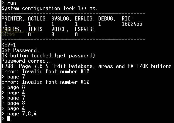

Anyone else seeing this?
MM+ ver 5.0405
I keep getting this message when calling GUI pages - but I am not using any font #10.
Font #10 does not exist, either in the library or in any other form.
Font #10 is not referenced in any GUI pages, including pages 7, 8 and 4.
I do use fonts 7,8 and 4, but I don't use a font #10
Fonts 7 and 8 are in the library.

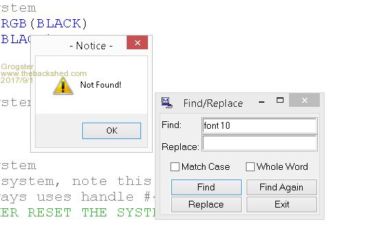

EDIT: MMEDIT finds no reference to font #10 anywhere in the code:

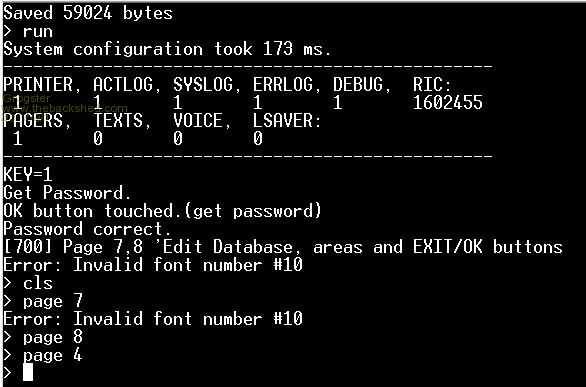

Hi there. Thanks for posting. It's nice to know I am not insane.
Yes, this is indeed very interesting.
I reflashed the PIC32 to 5.0405 to be totally sure I did not have corrupted flash or something, but same problem, so I suspect a bug.
I have been able to narrow it down.
In line 700 - PAGE 7,8,4, if I make that PAGE 7,8, it falls over with the same error, but if I make that PAGE 7 this works just fine - no font #10 error message.
Naturally, this means some pages of GUI are not there, but the purpose of this test, was to try to home in on where the problem is.
Next thing to try was some console commands, and it seems to be directly linked to my attempts to call GUI page 7. I can call any other page I like - no problems, but as soon as I call page 7, I get the error:
EDIT: MOST strange. Now I put the PAGE 7,8 back and it worked. So I changed it again to PAGE 7,8,4 and now THAT works, and everything works as it should.
I have not altered the code(other then playing with line 700), I have not changed the library. WTF? Edited by Grogster 2017-09-02

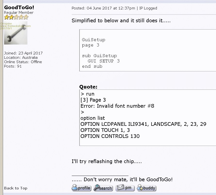

Posted: 04:34pm 31 Aug 2017
Hey Grogs,
Sounds remarkably similar to the issue I had back in June..... Page 3 invalid font
Never got it sorted out, ended using a different page number....
Good luck!

@ GoodToGo - Yes, I remember that thread now! Re-reading it now, I see I even posted that I have a big program with lots of pages and no problems. Now it is this same big program with lots of pages that is doing that odd invalid font message - I posted too soon!
@ Panky & KeepIS - Yes, was not working, then suddenly started working again and I don't know why. Very strange stuff.

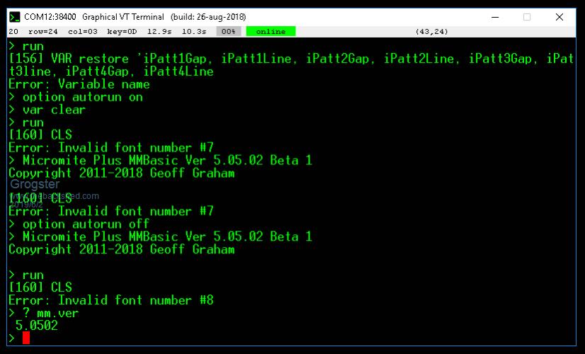

Here is another shot of the problem - it appears to be self-correcting, but only from the command-prompt:
Note that it fell over at the Font #10 thing again, and that typing PAGE 7 results in the error. Typing PAGE 8 works. Typing PAGE 4 works. Typing PAGE 7 a 2nd time, then works as it should. Typing the full PAGE 7,8,4 then works fine. Running the code then works fine.
Not sure if that helps at all, but feels like a problem calling the PAGE command more then once for certain pages. PAGE 7 was the problem last time too - not sure if that means anything.

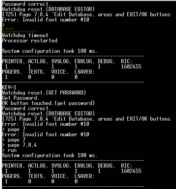

Posts: 10042
Posted: 02:39pm 06 Sep 2017
UPDATE:
Appears to only happen from power-up.
That is, from initial power-up, you get this error if you are going to get it, but you can work-around it at the console, by calling the offending page TWICE. The first attempt(at the console) always generates the same error, then 2nd attempt does not.
From that point on, RUN the code, it works fine.
Even CPU RESTART and the code works fine.

Blanked the MM+, loaded with below and.......
memory
Flash:
1K ( 1%) Program (7 lines)
99K (99%) Free
RAM:
0K ( 0%) 0 Variables
0K ( 0%) General
101K (100%) Free
> list
GuiSetup
Page 3
Sub GuiSetup
GUI SETUP 3
End Sub
> run
[3] Page 3
Error: Invalid font number #16
Hope it helps with the bug squashing
GTG!
