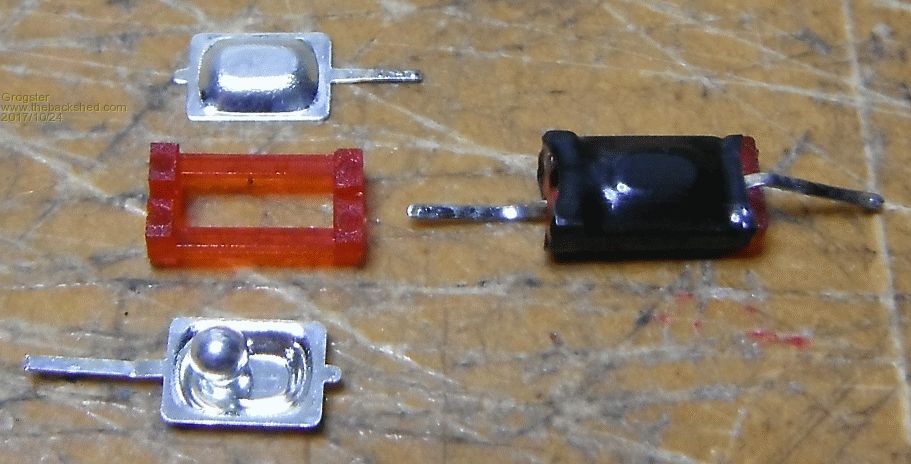

Ahhh, I see what you are referring to. I call those 'Opto-interrupters'.
Here is a photo of the guts of a sensor I cut open:
You can see that when the unit is tilted, the ball rolls to one end or the other, and forms a circuit with the top and bottom cups. Extremely simple, and effective - once I disable the PULLUP option.....

The fact that it works ok with no pullup and flaky with it on says the 'pull down' effect of the ball is poor. Could there be a slight coating (oil) on the ball. Give it and the cup a clean with some solvent and see what happens. Probably silly but ...
Cheers, Alastair

Alistair mentions something similar at the top of this page, but when I examined a switch I cut open under the microscope, the ball and cups look very clean. But that does not necessarily prove anything if an oily layer was there, you probably could not see it under the scope anyway!
